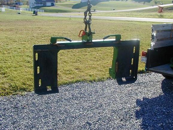

I had this made up last summer - Will post other pictures later.
Nothing like Imatch on the front and the back right ??? /forums/images/graemlins/cool.gif

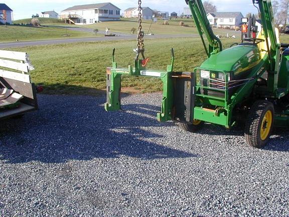

   / How to build a Skid Steer to 3pt adapter? #7
Pic 2

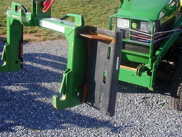

   / How to build a Skid Steer to 3pt adapter? #8
Pic 3

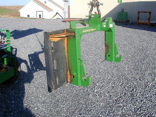

   / How to build a Skid Steer to 3pt adapter? #9
Last one - Like I said You can do anything with a blank bobcat skid steer plate.
