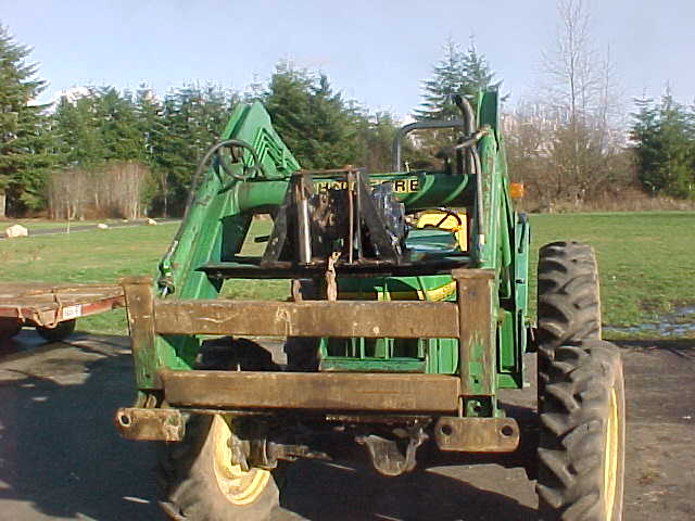

I built one for mine that is permanently attached to the front loader. It is an 8000lb hydraulic. It has saved me countless hours of work and of course the occasional pull when I need it. With a smaller tractor such as yours, I would consider an electric with standard 2 inch recievers front and back so the winch could be used on both ends as needed.
