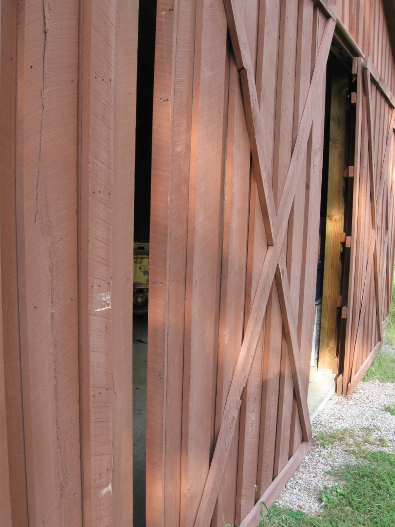

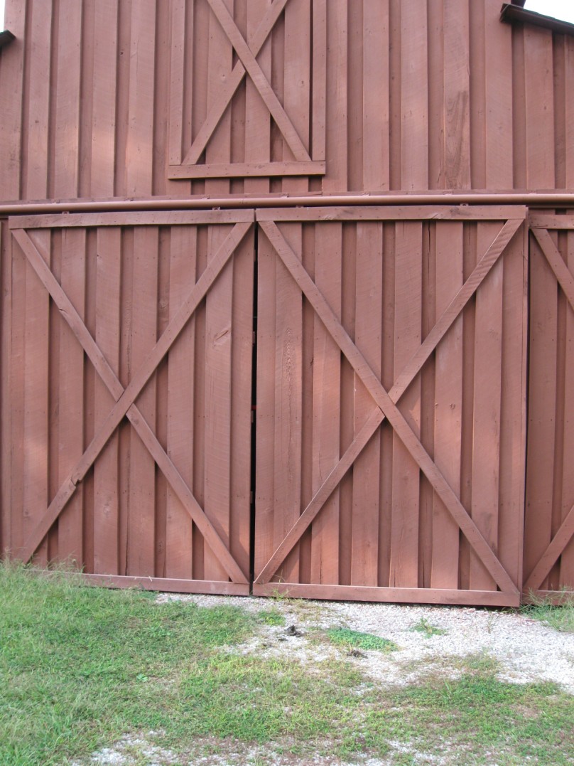

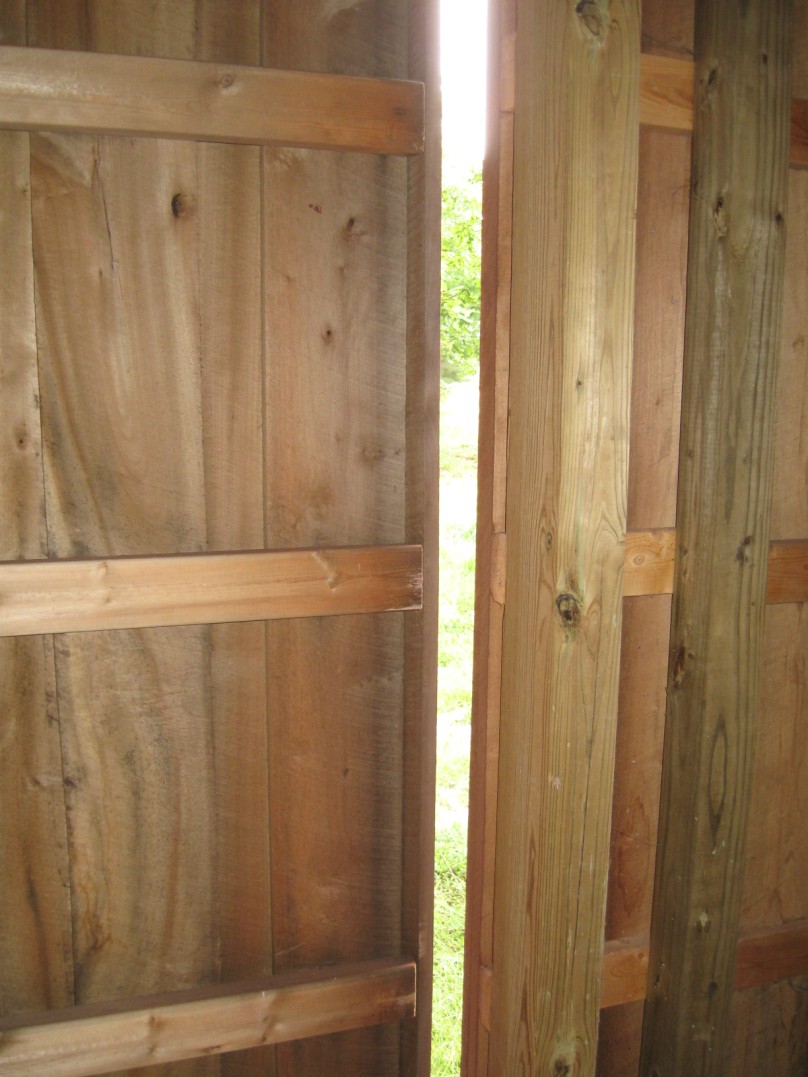

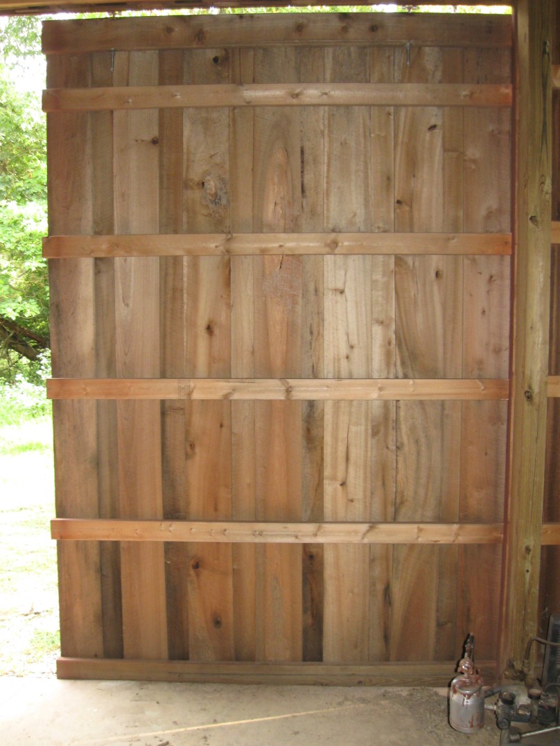

I had a pole barn build with poplar and the door construction was pretty simple. I had a request for some pictures from someone so thought I'd post them here. Hope this helps.
