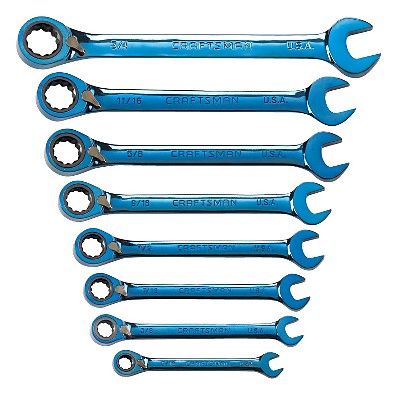

I used a wrench open on one end with an internal ratchet on the other. It was thin enough to slide over the bolt and the ratchet had it off in no time.
