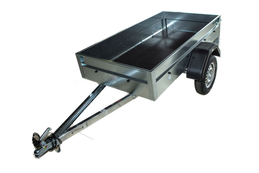

Hello everyone!
I am currently using one of these for my car, for random jobs.
I recently purchased a compact Iseki for my garden.
What should I buy in order to connect the trailer to my TU1600 ?
Should i got the 3-point hitch kit route + draw bar? If yes, which ones?
Thank you!

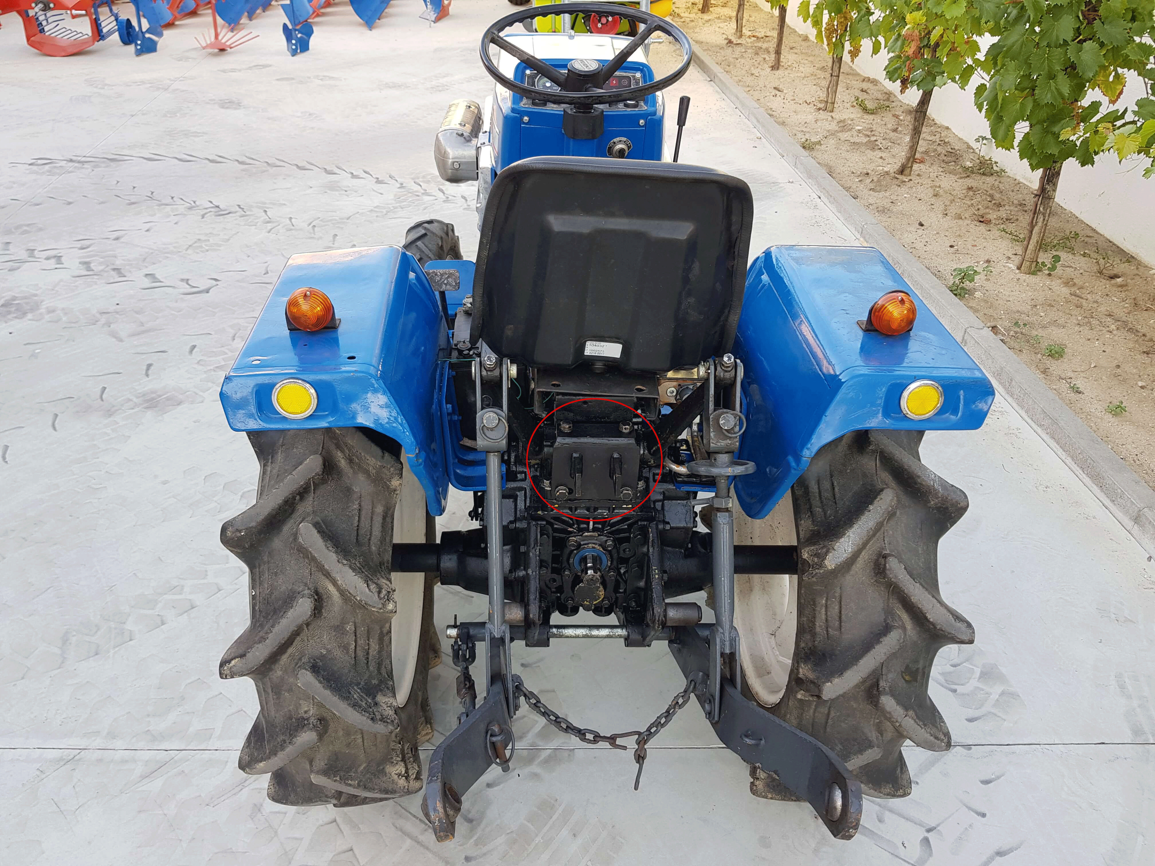

   / How to connect a small trailer to a Iseki TU1600
After a quick look, i think I am missing a pice of the puzzle... What is this piece called? Can i find it online or do i have to build it?
   / How to connect a small trailer to a Iseki TU1600 #5
that is where you attach the top link (3rd point of 3 point hitch)
yeah I know, that's not my tractor in the picture. Mine is missing it...
   / How to connect a small trailer to a Iseki TU1600 #7
That's the top link mount. You might need to Google: Top link mount Iseki
I don't know where you are located but judging by the trailer, you're probably in Europe. I've found a few mounts for sale in the UK.
On the other hand, if you have the tools for that, you can always fabricate one. It's a simple job and should require minimal tools to do it.

You are all telling the poster to use his 3 point hitch to tow a trailer. Yes this may or may not work. If you use it you must be aware the front of the trailer is not held down by the 3 point hitch. If the rear of the trailer is overloaded the hitch may pop up. The best way if the tractor has one is to use the draw bar with a ball attached. The draw bar is missing on the tractor in the photo.
