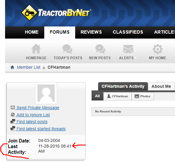

I'm guilty of doing this also but this thread originated in 2010.
   / how to contact a moderator #10
