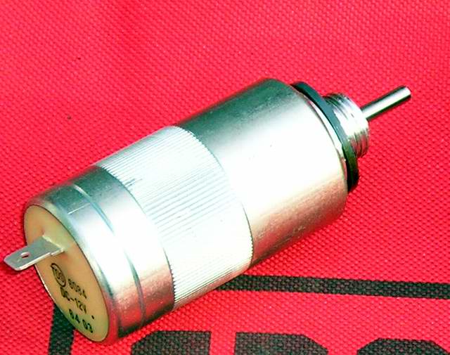

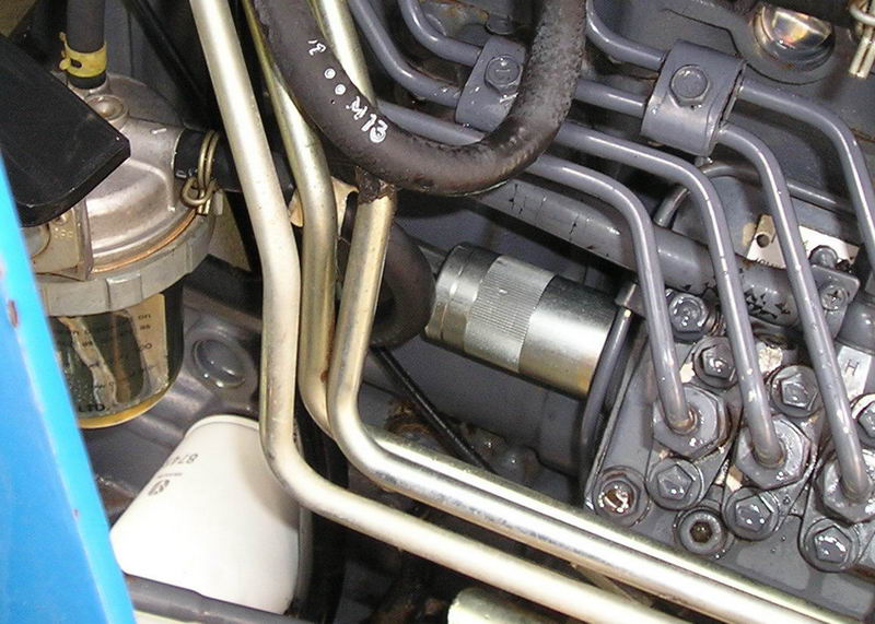

Good idea. How about pulling the 12V wire on the fuel solenoid? I found these pics jinman posted 7/23/11:
I think the fuse for the fuel solenoid is fuse #1 (7 amp). Looks like another wire splits off before it gets to the solenoid and goes to the alternator. I'll try it and see. (one of those "Here, hold my beer and watch this" times?) :thumbsup:
   / How to crank engine over with without it starting #7
On our TC40D the fuel solenoid is easily accessible - just unplug the wire and it will not start. (Remember to plug it back in or you will wonder why it won't start the next time and may not think of this wire)
That's the one I've been looking at. The silver cylinder to the left of the injectors? Just need to crank it for a few seconds. -thanks
