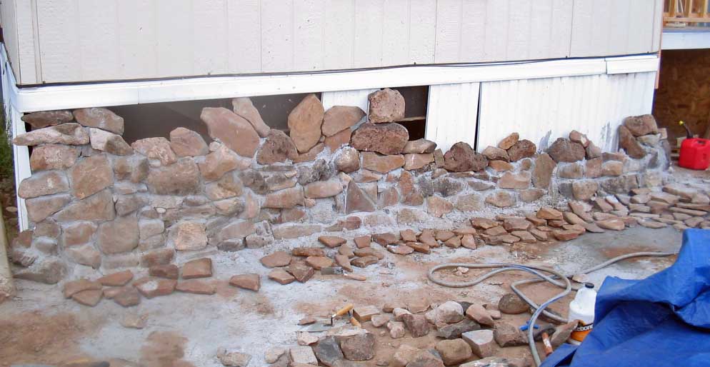

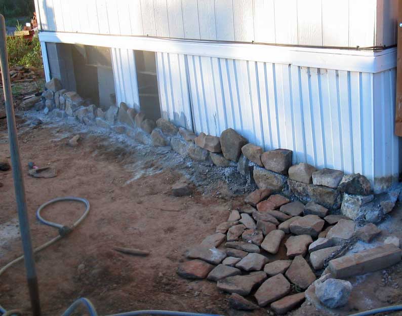

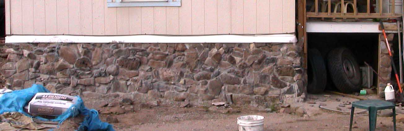

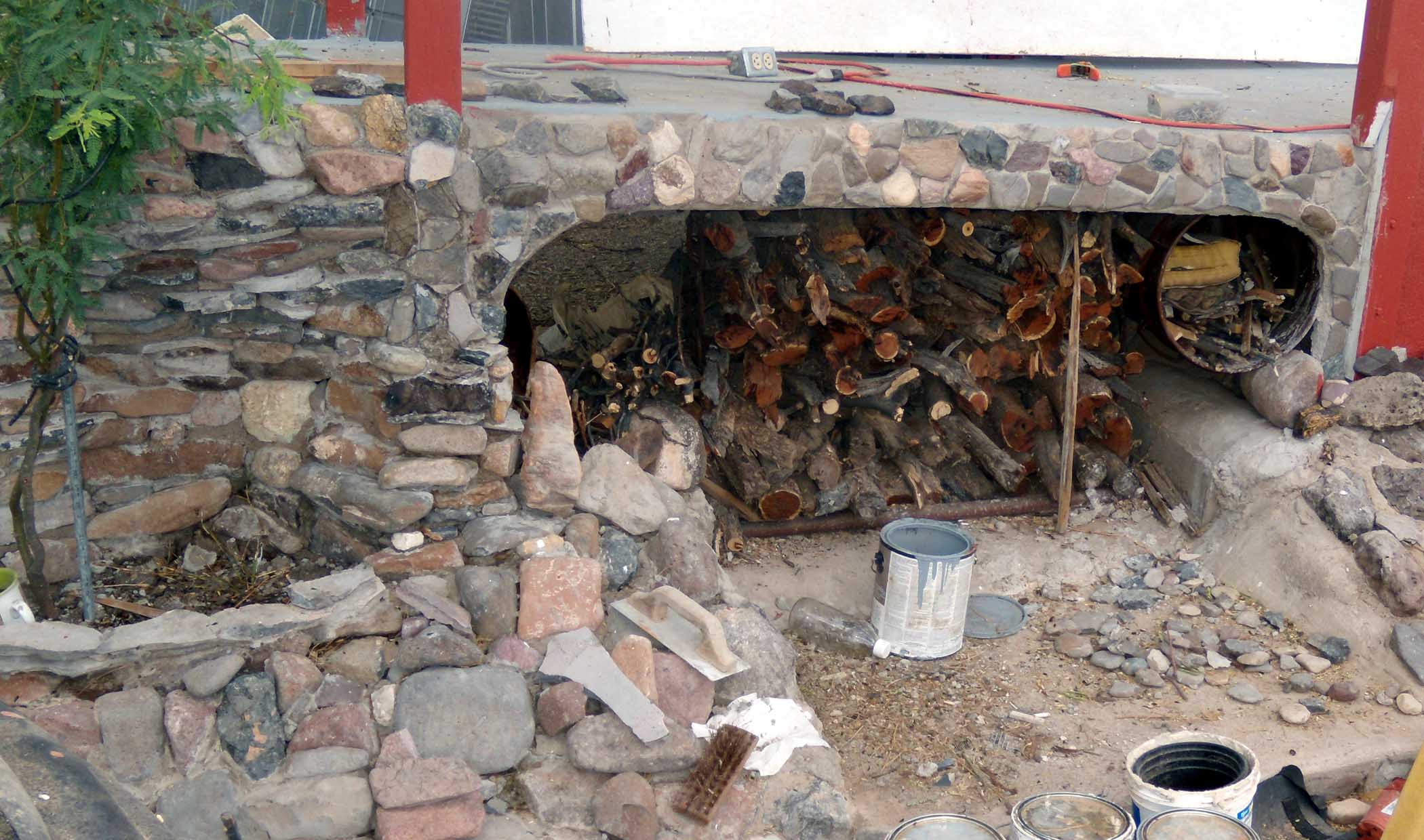

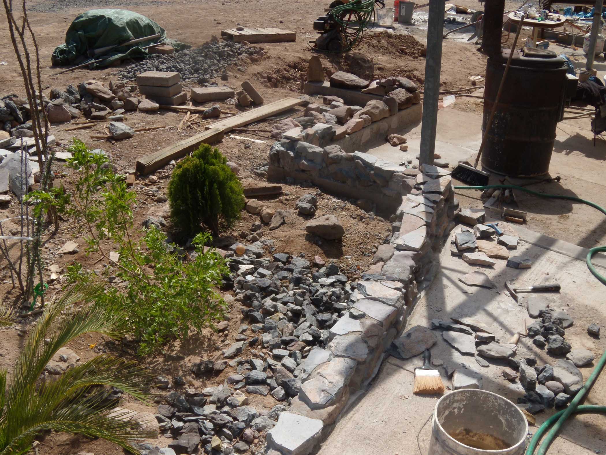

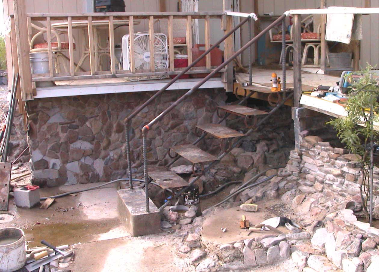

Some pictures and more information is needed. I do all kinds of "Natural" stone work. But with the information provided can offer no advice.

Thanx gentlemen, we heeded all your advice. The 36" wall is part of the perimeter of a large front porch that will require a total of 660 sq. ft. of stone for the three walls, steps, and concrete floor. About 300 sq.ft. of the stone will be for the stone on the concrete floor and steps.

Here is a good mix for setting stone.
- 4 "Fine" sand - 1 cement - 1 lime - about a cup of white glue.
Mix well and keep fairly stiff. It should stand up on your trowl.
Wash your stone and keep it damp while setting it.
More on setting if anyone is interested.
   / How to do natural stone work the correct way. #9

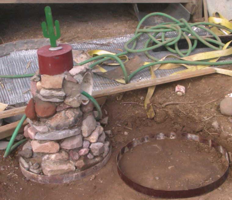

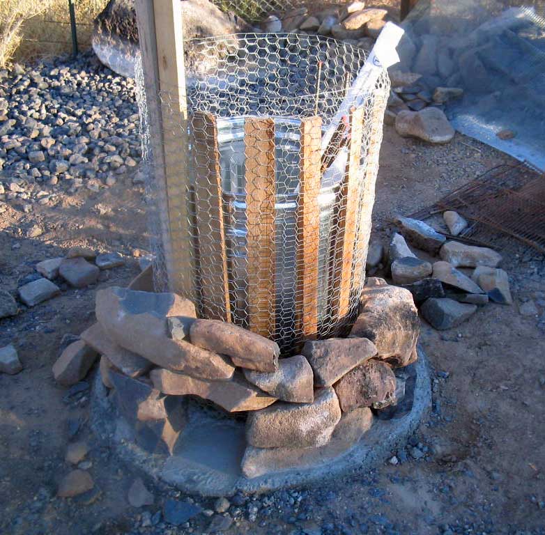

Below is general information, just something to help you get started with your plan.
Retaining walls and decorative walls are different. Most of the time a retaining wall is easier to build with filled 8x8's & re-bar and then a stone face. All stone is a lot more work but can be fun if you like to work. Both need a good footing, 12+" wide & deep or deeper. Don't forget weep holes, your not building a dam.
Most of the walls shown in my early post are veneer type. Single stone deep (This still needs a footing about 10" wide 4" deep.) or thin stone stuck to cement board or set in stucco.
Pretty on both sides decorative walls are the most work. Sure nice to have a helper for these as you want to work both sides.
Keep a stiff brush and bucket of water handy. Every now and then wash the stone of slopped on Mortar and clean the joints. Don't worry about the Mortar staining at this point. After the cement has set completely ( a day or 2) wet the wall down real well. When almost dry spray with muratic acid. Don't let it sit too long before you hose it down real well.
Easy to build is a "Form 1 Side" that gives you something to build against. You can also build a form 2 sides, fairly easy & fast. Dump in Mortar, set rocks close to face, more Mortar & more rock. As soon as the cement sets, pull off the face form and scrub with the stiff brush and lots of water.
