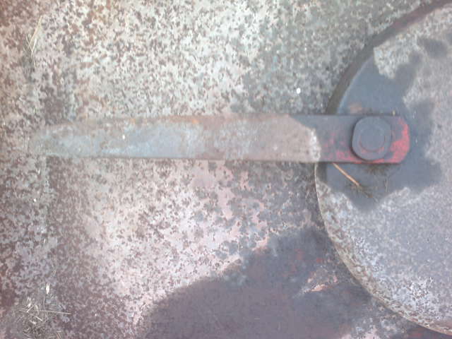

I was given a shredder and need help finding new blades...for some reason I am not able to upload the pic but could email it...please help!!! The blades are 24x3x half inch thick..they look like large knifes with points on them.

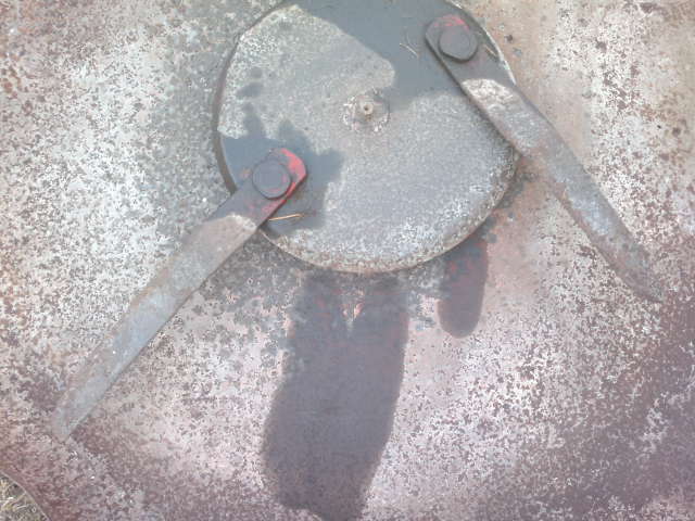

Ok I am able touplad the photos, but I have yet to get the bolts off...man what you guys do is hard tricky work. What if I can not get them off, can I cut that pi holding it on the other side? Do these pictures help any? 052020123237.jpg

About your mower;
You should have one or two corresponding holes on top
and directly over the retaining bolts that hold the blades
to the stump jumper.
The retaining bolt is or should be a splined bolt that anchors itself in the
stump jumper using a corresponding set of splines cut into the stump jumper
(like some truck axle studs)
otherwise you could not fasten and tighten the blade to the stump jumper.
ABOUT your stump Jumper,
I cannot determine if the stump jumper is secured to the gearbox stub with an allen bolt-if so you can remove it in one piece and then take the entire thing to an auto repair shop and have them use an air impact wrench to break the nuts loose on the bolts.
Your gearbox appears to be leaking oil and thats not good

Once you have them removed from the stump jumper
you will have a better idea about the blades Alanna.
I belive you have one blade that is damaged and the
other is intact.with a square edge.
Once you havethe following information you should be fine;
1. blade length from end to end
2. blade width
3. blade thickness
4. bolt hole diameter
The only othe rissue is whether the blade is hardened.
If tractor supply or menards or farm and fleet are close you
should be able to obtain replacements.
I would see about getting the oil seal replaced before you do any serious brush control and heavy mowing though.
