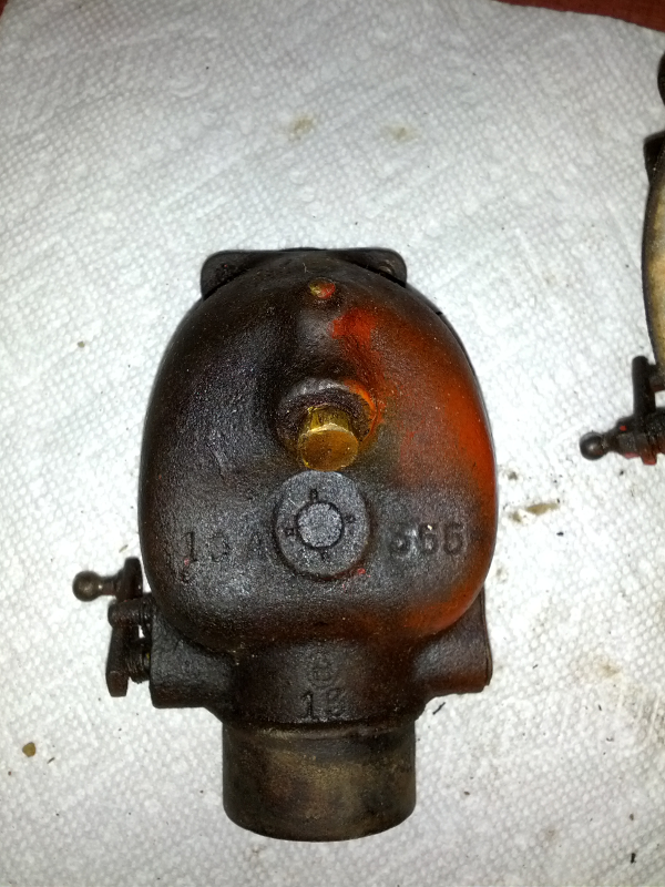

I'm looking for a carb rebuild kit for my ford 860, and having trouble matching it to the numbers listed for the rebuild kits (TSX...).
Below is a photo of the only number I can find.
It is a Marvel-Schebler.
Best I can tell, the numbers are:
13A 355
B
13 (or it may be 15)
Appreciate any direction on finding a rebuild kit for this.
Thanks,
Cliff

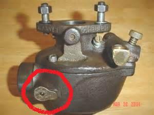

I'd sugest actually looking at the data tag on the carb.....
   / how to identify 860 carb
where is the data tag located on a 860 carb? I don't see anything obvious.
   / how to identify 860 carb #4
PS.. in the end.. you either have the large MS carb, or the small MS carb. there are only 2 MS carb gaskets used on those size fords... they are different enough you can easilly eye them up with the package next to the carb...
