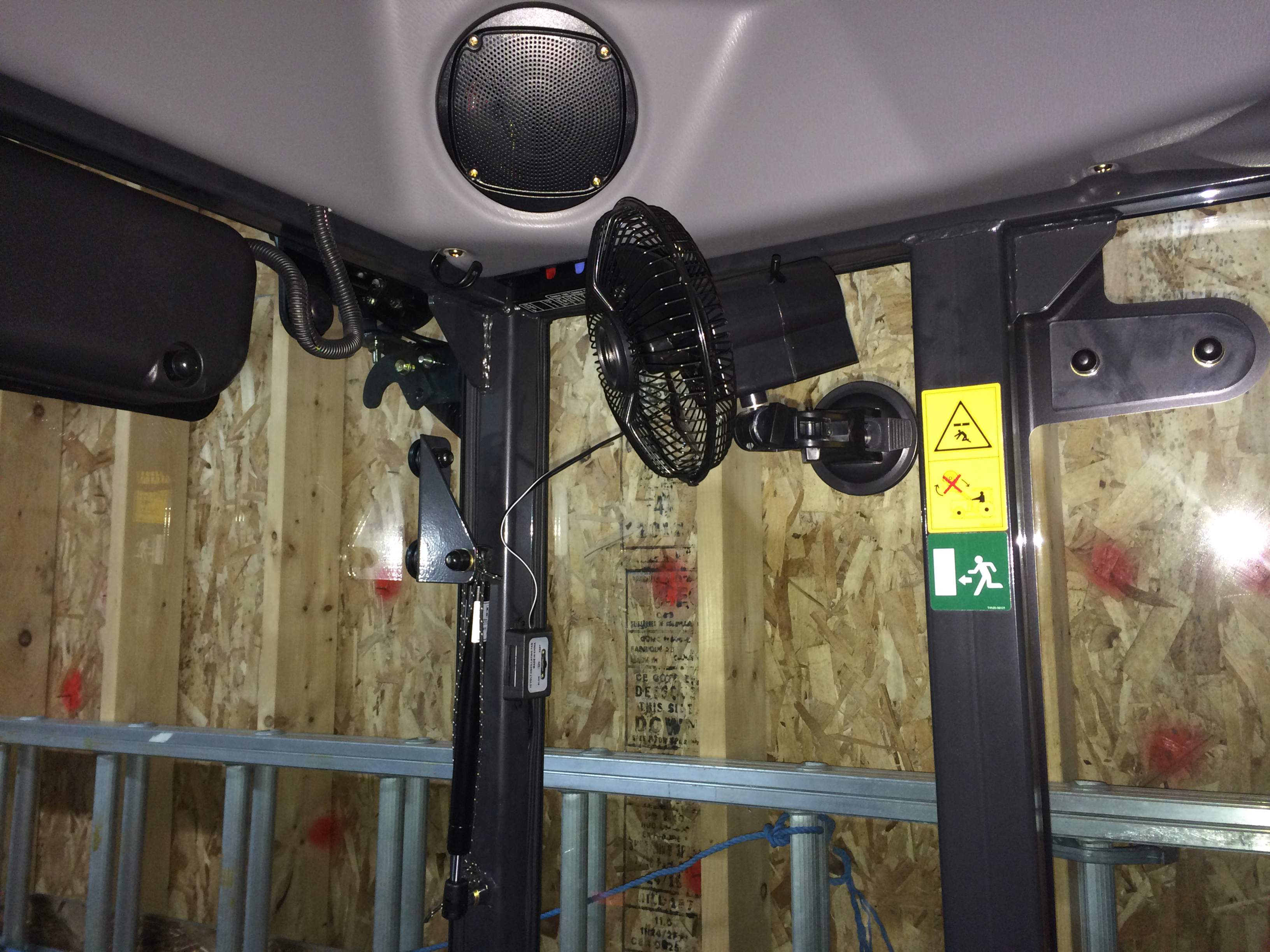

Hi all. I bought a 12v fan for my kioti. The end has a cigarette lighter like plug in my tractor does not. So what would be the easiest way to install this fan. Install a cigarette lighter or cut the end off the fan and wire directly to battery or fuse box. Any pics , diagrams on how to would be appreciated. Thanks

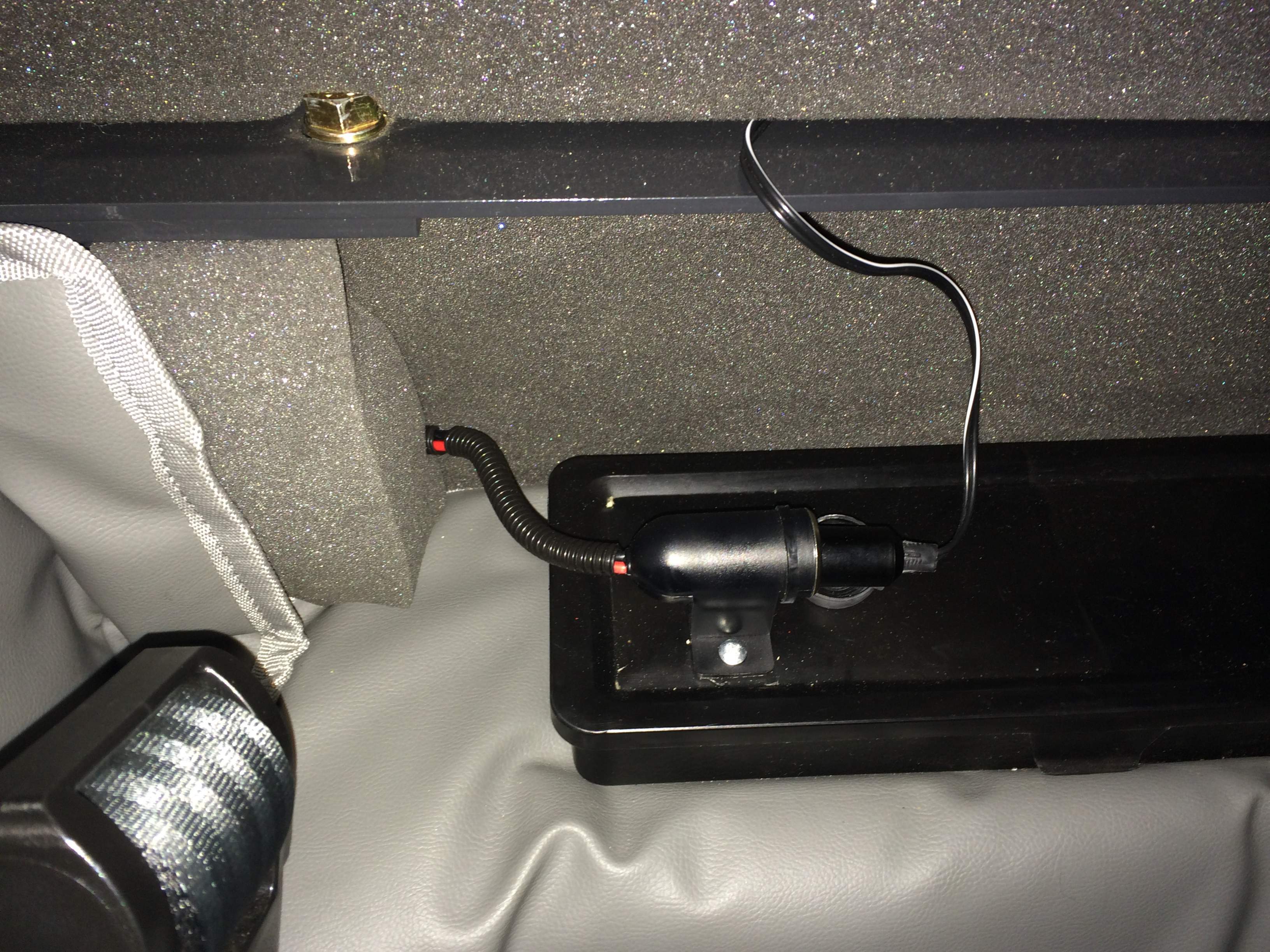

I'd also find other uses for a cig lighter socket, so that's what I'd install. If there a dash knockout hole for one, panel mount it there. Various surface mount types are available, one example:
12V DC Adhesive Power Socket | Princess Auto
You need to fuse the + lead at the source. If you have an empty circuit in the fuse panel, use that spot. Otherwise, install an inline fuse at the battery + terminal. You can run the negative lead to a solid frame ground, or the negative battery terminal.

Kman, there is a customer use plug near the right rock arm taped up with the wire loom. Bottom fuse in the box 15A. There is also a 7.5A fuse second from the top labeled back up lights/ work light. On my ck35 hst model the connector is under where the right rops attaches. Black and a red/brown wire. My tractor is not using them. Was at the dealer the other day and he was assembling a new ck30 gear tractor with a backup light which used these wires.

Truckstops sell the alligator clip on cigarette lighter plug that you can purchase for about six bucks if you don't want to permanently wire something in. I think they come with about 8 feet of cord. However I think having a cigarette lighter plug would come in handy in the future. So if it was me check out the customer use wire or run new wires with fuse to battery.

I used a suction cup mount fan and installed the Cig plug behind the seat on the tool box. Power comes from acces. wire located by the right fender ROP's. Works like a charm.
