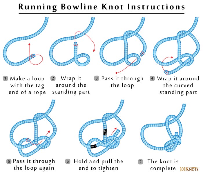

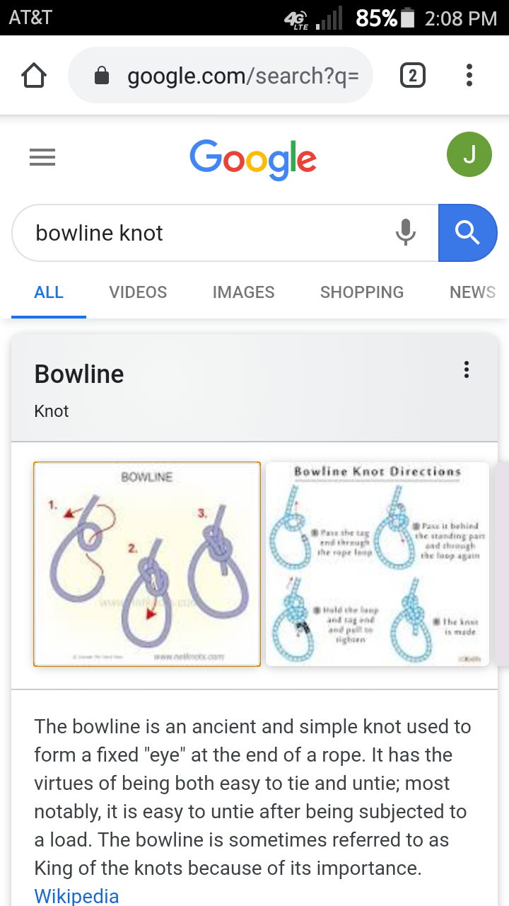

   / how to keep a knot from tightening too much when lifting something #5
The running bowline has the anti-tighten quality of the bowline plus it will tighten up on whatever you tie it around.

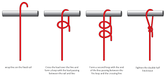

Knotting straps is really a no-no and doing so significantly reduces the lifting capacity of the strap, as far as I know.
That being said, you might try half hitches like shown in the above image, or a variation such as a cow hitch.
This knot slips and becomes a choker though. Perhaps this would not work for your application.
They are usually pretty easy to take apart after use though...
