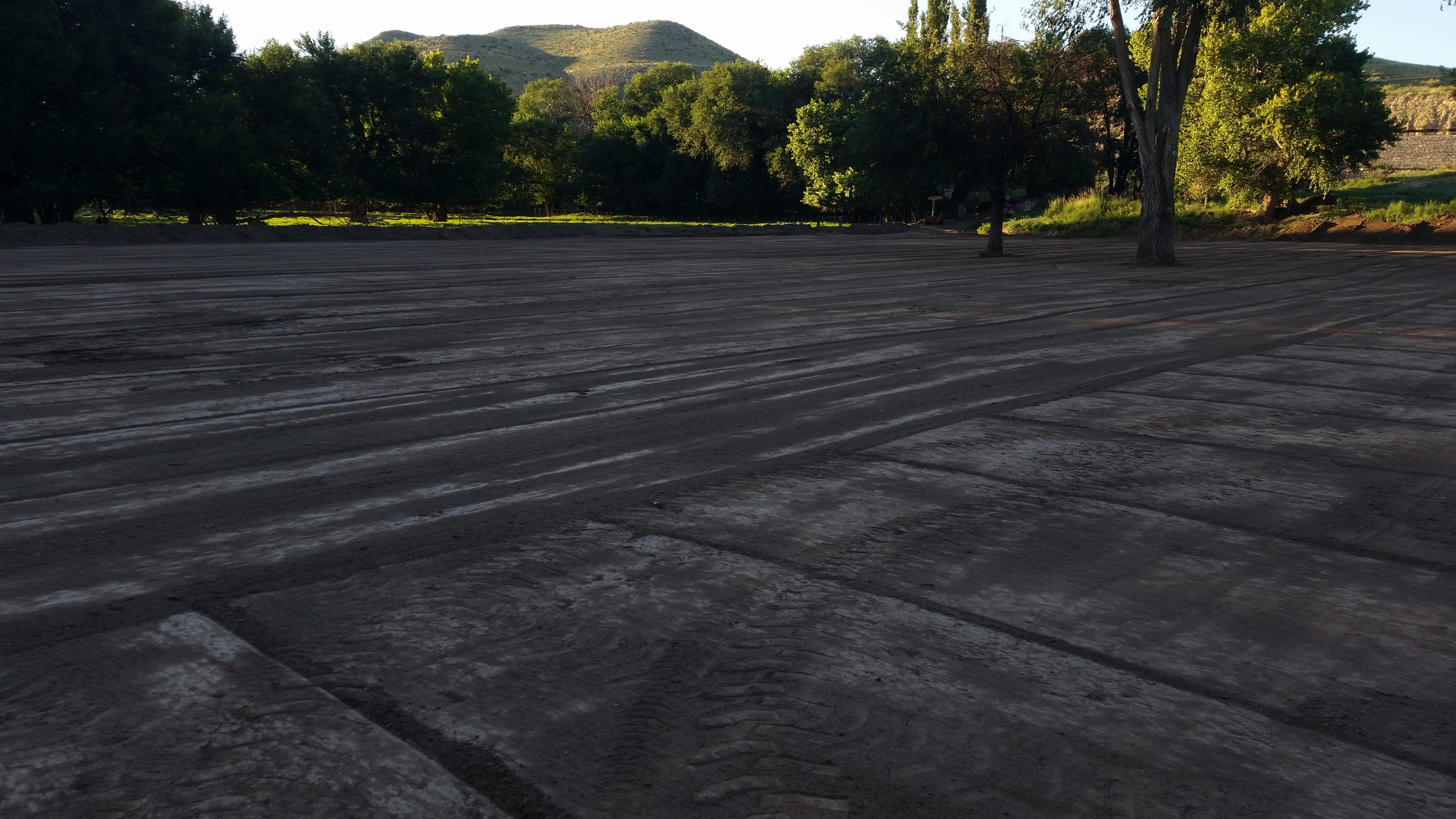

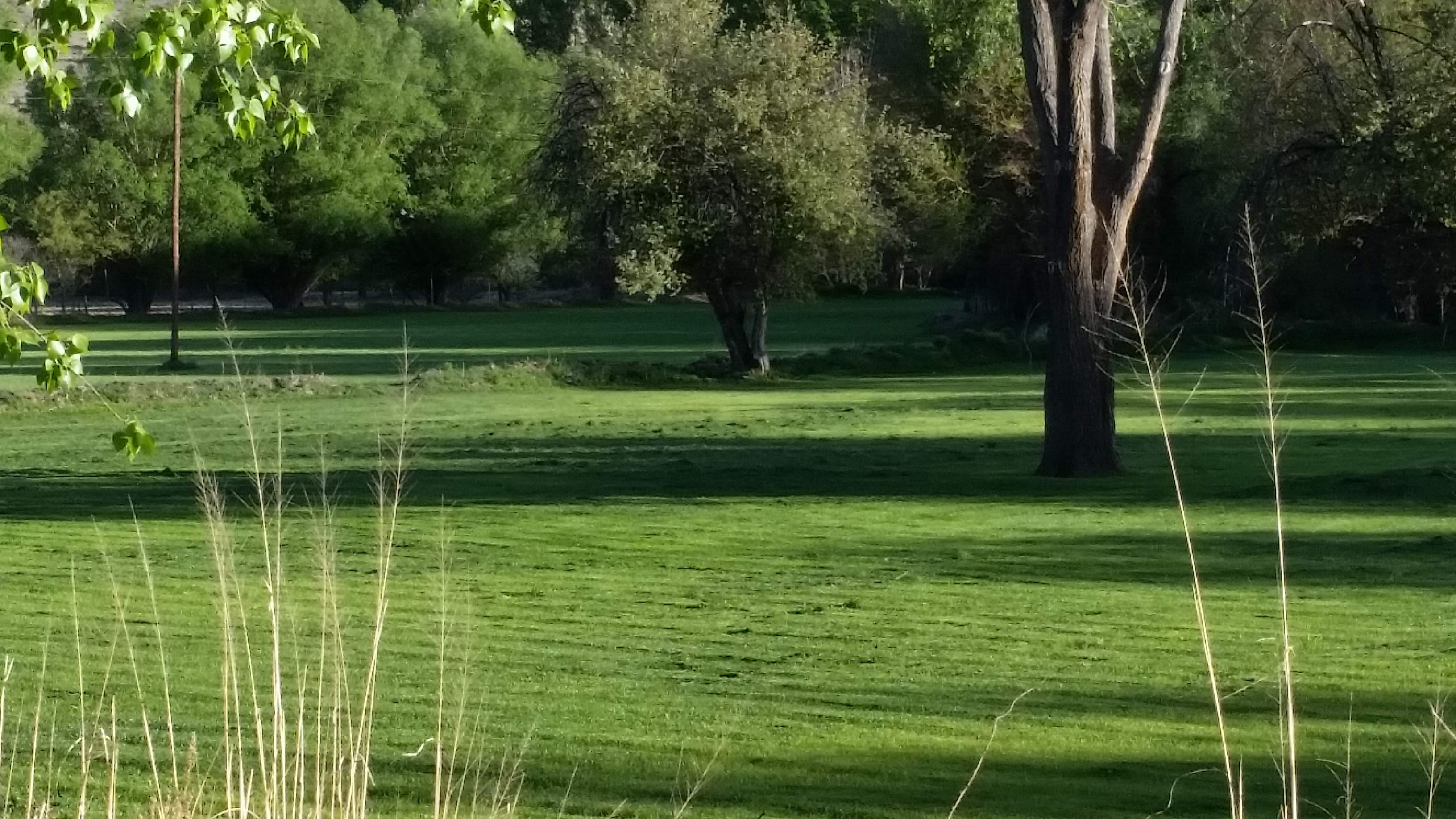

I can't help you with the topsoil thickness issue but the USDA conservation office in your locale can and will help.
For the leveling I can offer a couple of suggestions as I do a lot of this type work.
A grade laser that can be adjusted to the average slope or slopes and a laser receiver mounted to a pipe on your box blade or pull type drag box can provide visual indication of blade height, plumb and tilt. This would be a simple way to grade accurately and know when you are on grade or not. As you move across the field you can feather the hydraulics for height and tilt according to the receiver indicator lights which will tell you to raise, lower or adjust tilt.
You can buy this equipment or rent it depending on how much you plan to do now and in the future.
Since I do a lot of this work it made sense for me to buy the equipment for full automatic machine control. This stuff can be rather expensive and I would not recommend buying it for just a 3 acre project. You should be able to rent the laser, tripod and larger receiver for a reasonable cost for a week or two. You may need to add the pipe and socket for mounting to your box blade/drag box at your own cost.
I would use the L47 and rototill it so it is smooth enough the the tractor doesn't pitch around much. Then attach the box blade with the laser set up and find the average slope from end to end of the field. Same for average across the field. Adjust for best fit to your field. Your R4 tires should work fine since you should not attempt this type grading while a field is too wet or muddy. You want the ground to crumble in small pieces for fine grading.
Here are a couple of pictures from 2014 when I started out with the simple system described above. No automatic machine control but I did get pretty good at turning around and stretching my neck. This will take lots of seat time but you get better at it as you go. A good heavy roller and a wide land plane grader scraper also help with smoothing and packing.
You do very nice work. The road in front of my house is not as smooth as the pictures you posted.:laughing:
   / [How to] level & break in new field #9
I agree. Well done.

No kidding! Jenkinsph, that's smooth as glass! I'm not looking for anything nearly that smooth. Just to level out the stump holes mostly.
