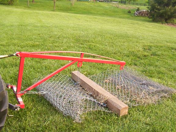

Like the tire dragging, I've used a piece of chainlink fence with a pipe on one end to hook a chain on and drag behind the tractor. Adding and removing weight for more or less cutting by the fence.
   / how to level yard #7
If the dirt is loose, I have a drag I made up by wrapping chain link fence around 2 8 foot 6X6's. I hook it up to my boom pole and drag it around the dirt. It won't break up large, hard chunks, but is the best thing I've found for smoothing out lose dirt.

Are we talking loose or packed dirt? Do you have grass already there? Will you be planting grass? If so, what kind of soil do you have?
If you are planning to add grass, and your soil is like mine, this would be the time to rent a tiller and add organic matter and fertilizer. Then use your FEL in float mode, the afore mentioned landscape rake, or something home made (chainlink fence) to smooth. You could also add seed and a staw mulch after spreading.
