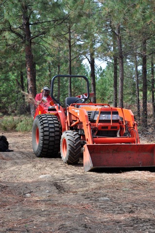

I have one of those Jinma Chippers. There are a couple of really good websites on how to prep them before use. A brief outline:
1.)Tighten everything;)
2.)Have a spare belt for the gearcase that drives the input drum, you will need it in 10 to 20 hours.:thumbsup:
3.) Replace lube in gearcase with any good 90 W gear oil.:D
4.) Grease the heck out of it every ten hours. I went an extra step to make it easier to grease and installed a remote greasing system for all four of the main pillow bearings. The zerks sit in a manifold on the front pulley cover. If I was home I would shoot a picture. This makes greasing them really easy. I also put a remote zerk on the inside bearing of the feed drum.
5.) The weakest part of these things is the drive line for the feed drum. There are two styles; a U-joint style which is newer, better and improved, and the older ball joint style. The only thing that holds the drive shaft to the squared ends of the ball joints is the spring tension. Sometimes this is not enough and the shaft or ball joint socket will get rounded off in the connection between shaft and ball joint. Many people have drilled and tapped the ball joint sockets and installed set screws to prevent this. The "many" includes me.:cool:
6.) One thing I have not done, but will, is to sharpen the the "teeth" in the drive drum. This is really helpful if you are chipping dry wood. Green works fine, but I am here to tell you dry Ponderosa Pine is another matter.:drool:
One last thing, after getting smacked in the face a couple times with flying chips, I invested in a face mask/hearing protection combination and now wear it religiously. I attached a picture of me feeding the chipper.
