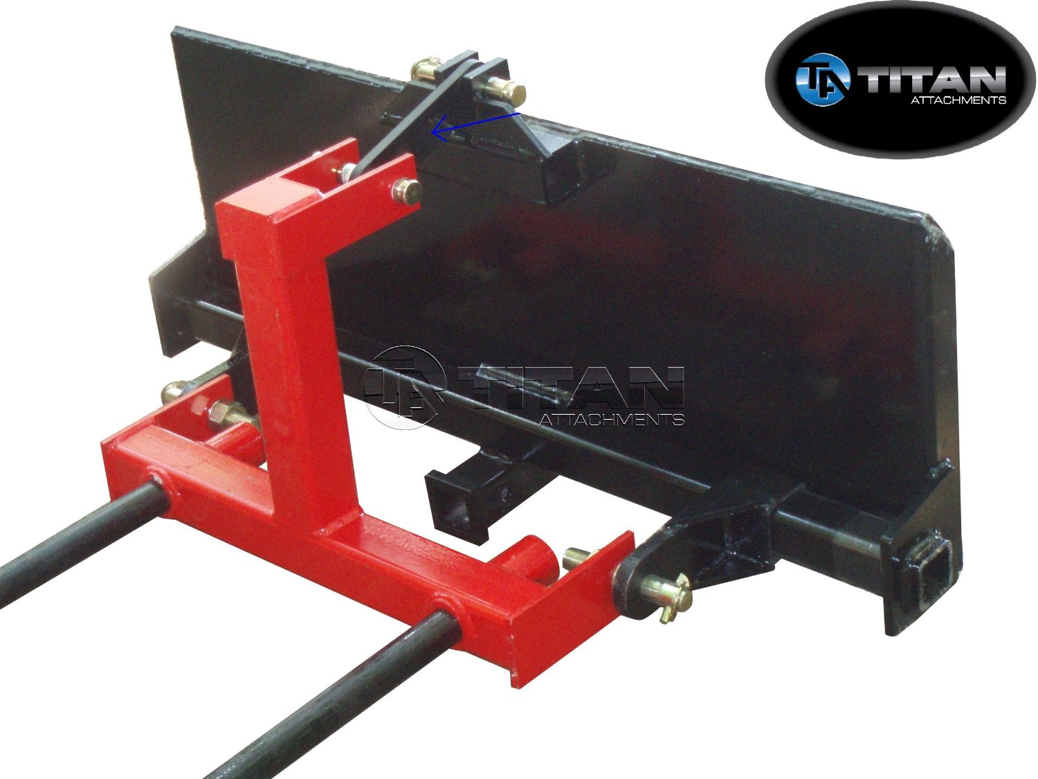

Just got a Titan 3pt hitch skid steer plate that is drilled for Cat 2. Picked up some Cat 2 to Cat 1 bushings at Rural King. Since I don't have any Cat 2 implements and don't plan to buy any, I'd like to have the bushings permanently installed. Should I do a couple of tack welds or is there a better solution?

Sorry, should have been clearer. The bushings will fall out if not welded. I also have a set of bushing that are 1 1/8" (vs. 1") that I could grind down and press in. Not sure it matters, just didn't know if there is a preferred method.

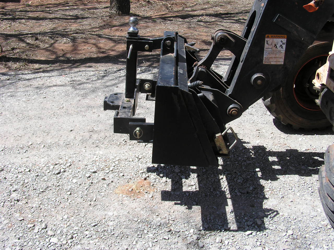

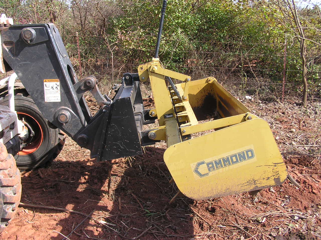

   / How to permanently install Cat 2 to Cat 1 bushing - weld? #6
Like this?
Make sure your changes will allow for clevis-mount implement pins as well as single-mount pins.
Bruce

Short answer. Yes, tack welding a bushing would work.
I've done similar when converting a CAT 1 to a CAT 2. But I bought CAT 3 to CAT 2 bushings then plasma cut the CAT 1 holes to take the CAT 3 to CAT 2 bushings and welded them in. Opposite of what you want to do.
EDIT: Or as Gary Fowler states, just buy CAT 2 lift pins for the implement(s) you intend to use on the front of your tractor. Wouldn't think there would be too many. Maybe a rake, blade, or bale spear. I have a rear fork attachment that would work on the front as well.

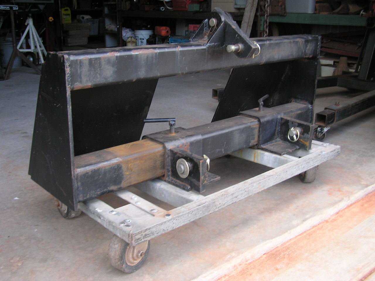

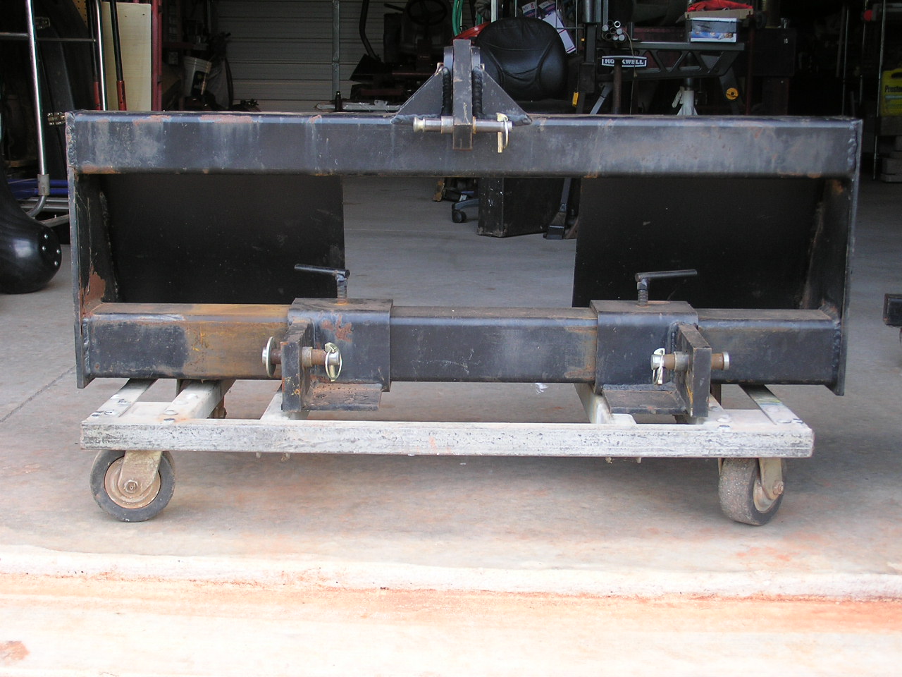

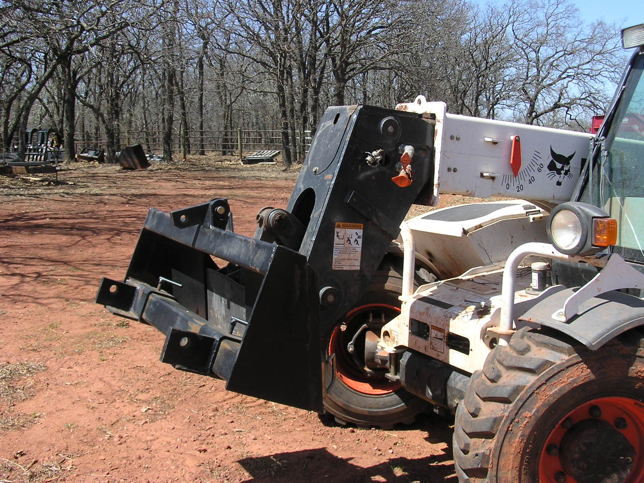

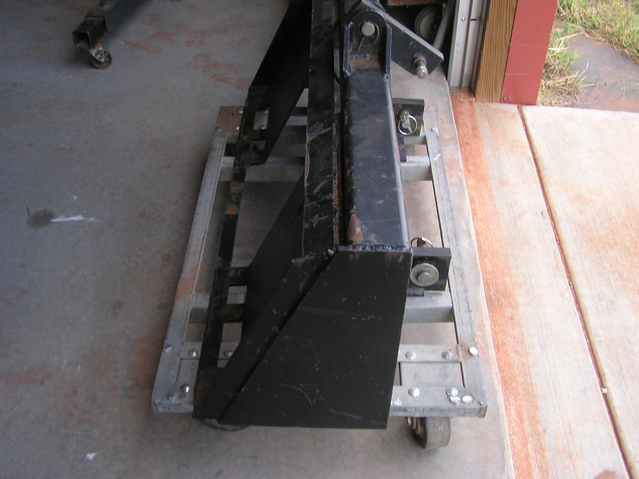

I have a similar three point adapter with cat 2 holes. It has more rollback built in, than the Titan.
The bushings can't fall out when in use and I store them in the hole with the cat 1 pin, when not in use.

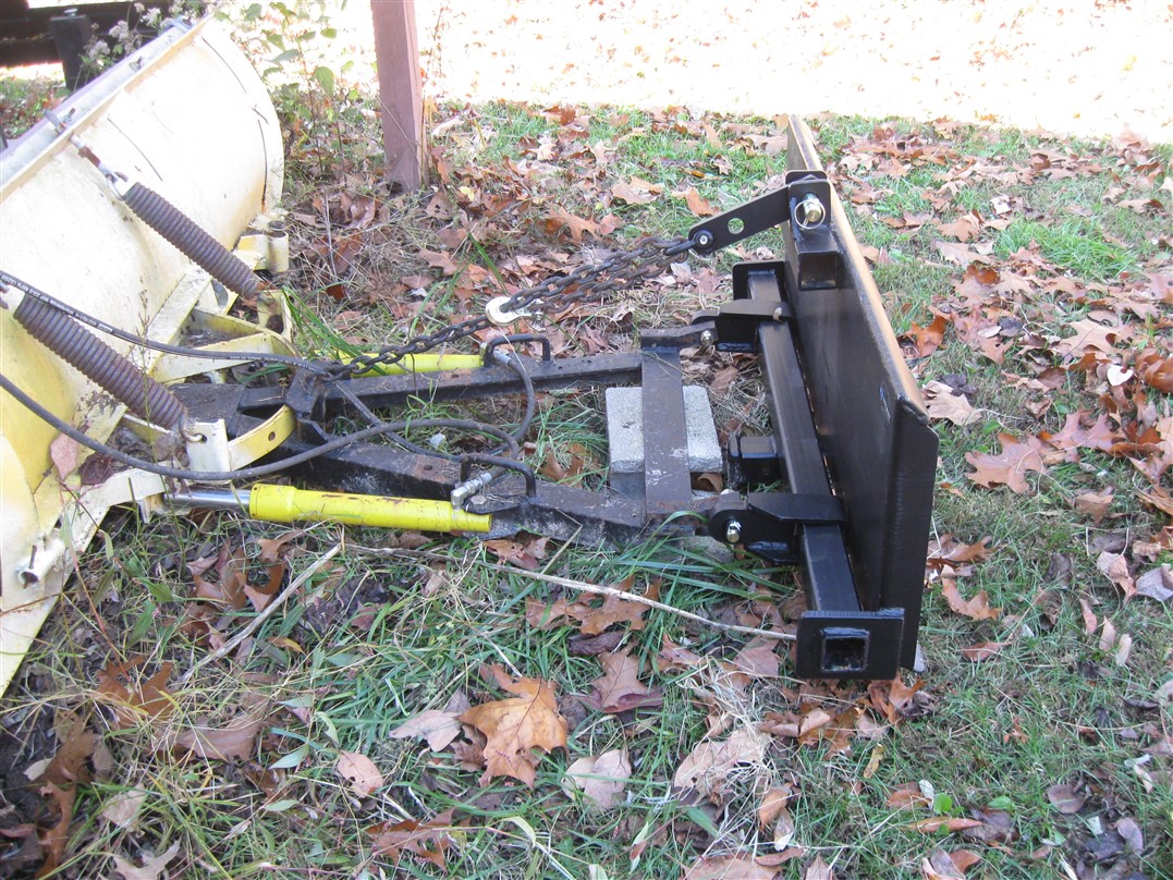

Here is my setup - the Meyer snowplow. I'm just using a Cat 2 pin in the top link. But in the second picture you can see the Cat link pin doesn't fit snugly in the lower arm. The bushi8ngs I've found locally are 1 1/8" OD. The holes on the plate seem to be more like 1 1/16". Sent a note to Titan (via their Web site) asking for a source of bushing that will fit, but never got a reply. Anyone know of a source for bushings that might fit?
Thanks

You need to press fit some bushings in that plate.
