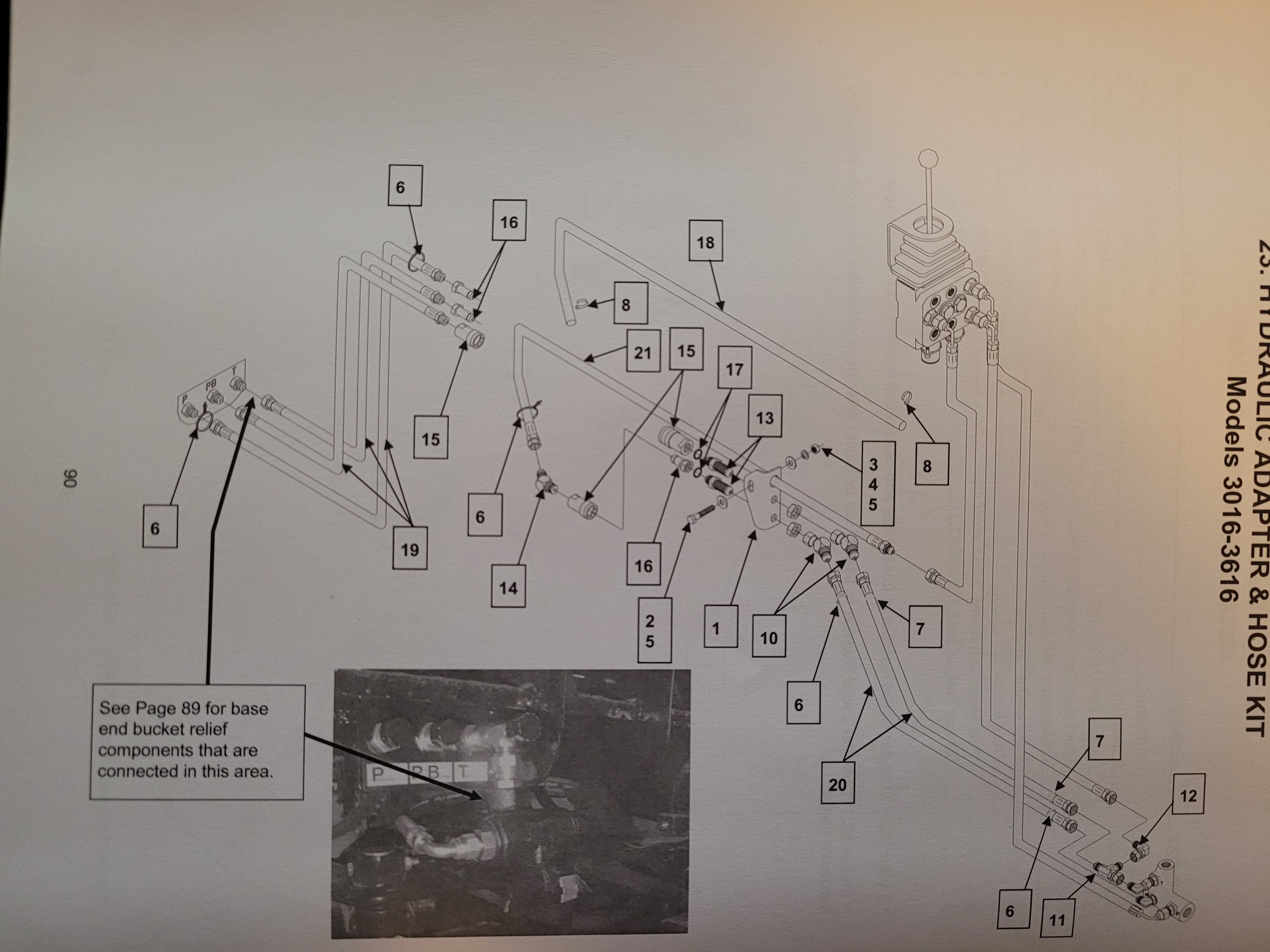

I have a Mahindra 3016 with a 3720 factor backhoe. I'm trying to figure how/where you plumb in a 3rd function valve to the hydraulics with the backhoe on there. Anyone have any insight?

I already bought the 3rd fintion valve. I think I need to connect the power beyond from the loader valve to the third function valve then the output of that to the backhoe on the same line. The weird thing is the backhoe has two lines in and then a tank out.

I can send you my drop box link for the 3016/3616 service manuals... i would come off of the loader power beyond to new valve "IN" port then on the "OUT" port hook it back to where the original line went that way it shouldn't interfere with the backhoe... somewhere on my posts on my 2638 on here i posted pics of the 3rd function i installed on my 2638. Close as i could get it to a W.R. Long setup. i couldn't buy the W.R. setup in canada with out a HUGE import cost etc. One dealer had or could get but was like double what i wanted to pay at the time...
