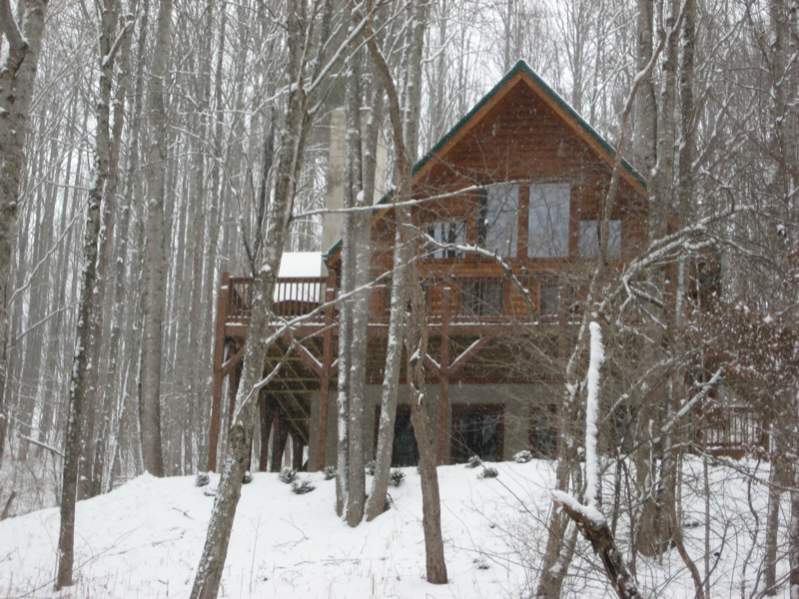

I have a quite a bit of tree's to clear. I have a grapple to help. I was looking for videos showing good technique. Most my land is hilly. I also have lots of dead leaning trees.
Thanks.

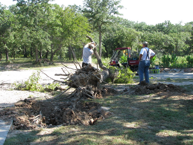

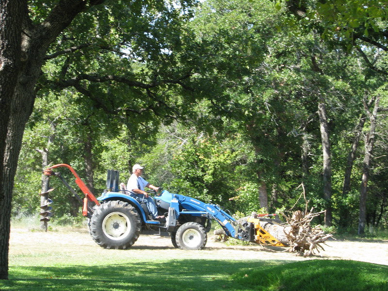

I find using a grapple to push over trees about as easy as pickin' my nose with a chainsaw. You can do it, but there's gonna be collateral damage.:shocked: I think you will bend tines and likely not be able to do the job efficiently.:(
When I can't use a backhoe, I use my smallest bucket to dig around, through, and under the rootball. I even prefer my non-toothbar bucket for this. I also back up and pulled my 3PH subsoiler through the roots a few times to break them loose as close to the tree trunk as I can get. Luckily, most of my trees don't have big root balls or tap roots.
As many have mentioned, shoving or thrusting against the trunk of the tree will most likely bring down dead or brittle branches. If I can't ease into a tree and gently push it over, I just keep digging. I simply refuse to back off and take a run at the tree. My equipment and my life are worth more than that.
Here's a picture of an oak tree that was not healthy and beside my driveway. I used my 5' bucket to dig around the root ball and then just eased against the trunk and brought it down. After cutting off the limbs, I put on my rock bucket/grapple to move the tree to where I cut firewood. The PHD on the back is because my grandson and I were drilling some post holes after moving the tree.
