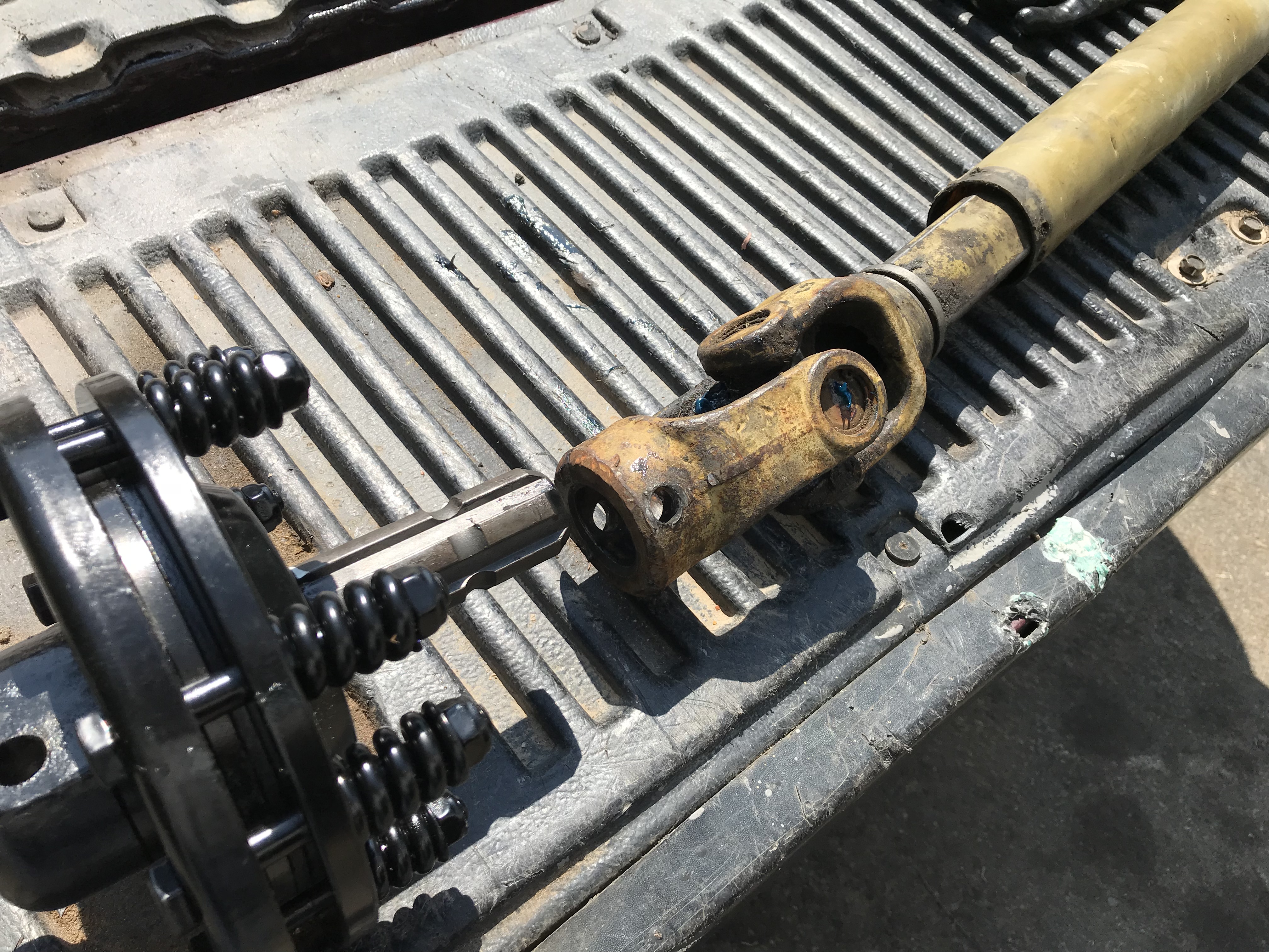

Ok i cat sick and tired of putting bolts and nuts on my ****** field cutter from tractor supply. So I got the clutch and now I see that it doesn稚 match the yoke which on the existing rig is smoothbore as in the picture I suppose I have to get a yoke because iThat fits way too sloppy to leave it like that. What do you call it where is everybody getting in. As always I just knew it could never be that easy. 334E2CBB-70E0-4774-936A-946CB9400567.jpeg

You have the wrong slip clutch. You purchased the splined version. there is also a smooth bore version that should of been on the shelf next to the one that you purchased.
Weasler Universal Friction Clutch, 1-3/8 in., Round Both Ends at Tractor Supply Co.
I converted my rural king cutter that I purchased years ago with the TSC smooth bore version of the slip clutch due to the fact I got tire of breaking that grade 2 shear bolt, and if I tried to engage the mower with the rpm's even slightly above idle I could shear the bolt on start.

Yup I wasn’t thinking when I ordered that clutch. Ah well at least I got it a whole lot cheaper. I guess I’ll either be modding that shaft Toto fit or grabbing a splined yoke. Ahhh wells sometimes it goes that way.....

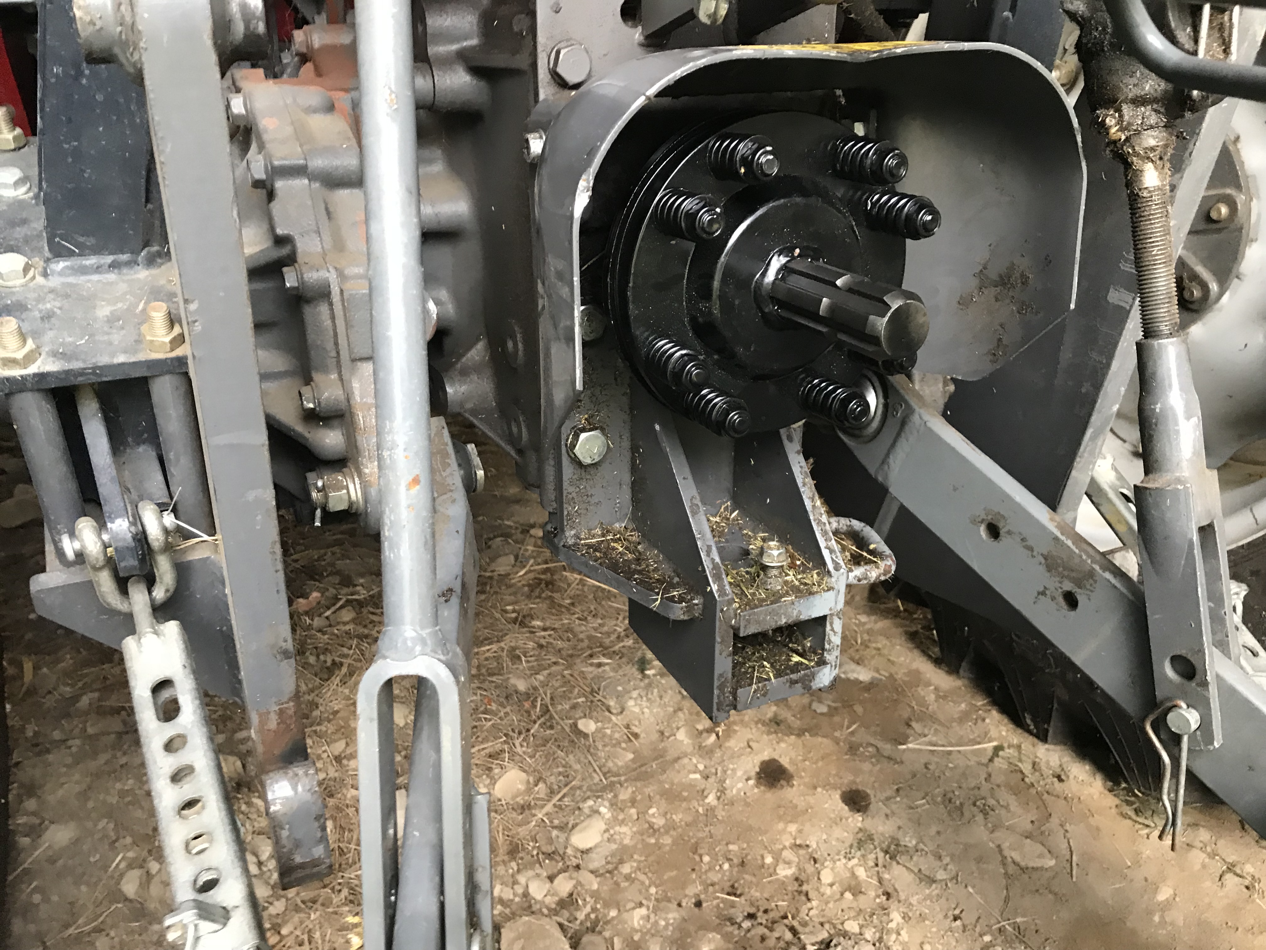

Backwards. Looks like it’s gonna. Be fine
