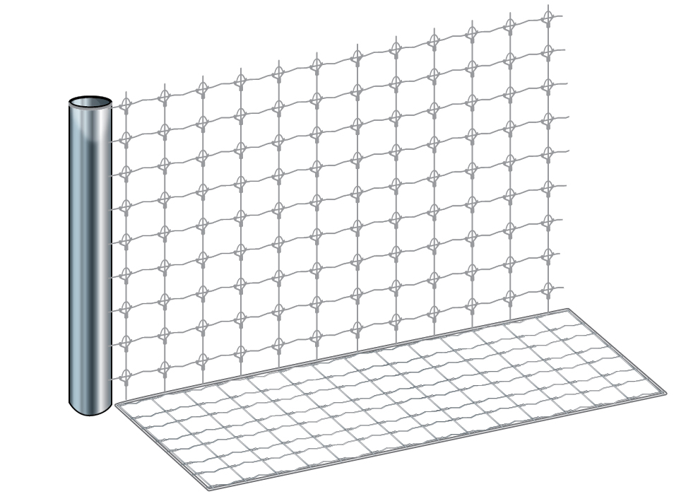

Have a 50' x 50' enclosed garden area. Woven fence 8' height because of heavy deer population. Been in place 25 years and need to straighten corner posts and replace wire fence. Deer are not a problem, but past several years we have rabbits digging under the fence in many places. I patch the hole and they just move on. If I replace all the fence wire, I want to stop the rabbits. What are the best bottom fence options and how deep do I need to bury?

What I found works well for me is to take chicken wire and only bury it about 4" but turn it out flat for about 18". They start digging at the fenceline and hit the horizontal wire. The are not smart enough to back off 18" to dig.
   / How to rabbit-proof large garden? #9
I have heard that you could just lay 8 or 10 in of chicken wire on the ground and staple it down with big staples made of stiff wire. Make sure not to leave a gap at the bottom of the fence. The best might be to turn it up onto the fence a little and then out from the fence on the ground. Hope this helps. Ed
