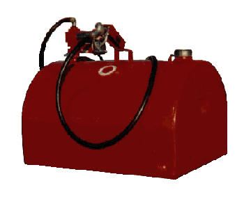

I bought a 100 gallon tank with a 12v pump that is rated at 15 gallons per minute. I have to throttle it back when fueling my tractor but that is what I would get if I were you and did this on a regular basis. The tank sits nicely between the fender wells at about 3.5' x 3.5'x 3' tall feet in size and is not to high to see over in the back window. I run it off a small jumper battery that I picked up for $10 at a pawn shop when it is in my shop.
   / How to refuel diesel tractor that can't be moved? #6
Tidy tank.:D
