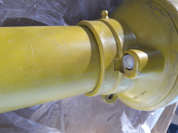

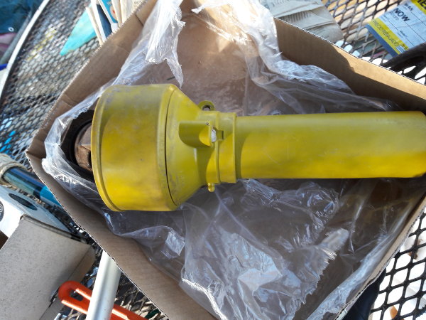

Hi Everybody,
I have this Agritec AT20-150 Italian-made tiller that I've been rehabilitating, specifically getting the Eurocardan PTO shaft collar to become unstuck. So I separated the two halves of the PTO shaft, secured the end that goes on the tractor in my shop vise, removed the snap ring, got out the PB Blaster and the rubber mallet, and started whacking. Mission successful! I was able to dislodge the ball bearings, clean and reinstall them. The collar now works great. However, during this whacking, the yellow plastic PTO shaft shroud decided it had had enough, and fell off. Anyone know the proper procedure to put it back on? Or is it a one-time thing and will require buying another shroud?

Dont know for certain but would expect turning the white plugs 90 degrees would free it or lock it in place. Pull them out after they are turned.
All are made for disassembly and re assembly

Agri-Supply (ASC) sells the Eurocardan shafts and guards. Maybe their website has assembly/disassembly instructions?
