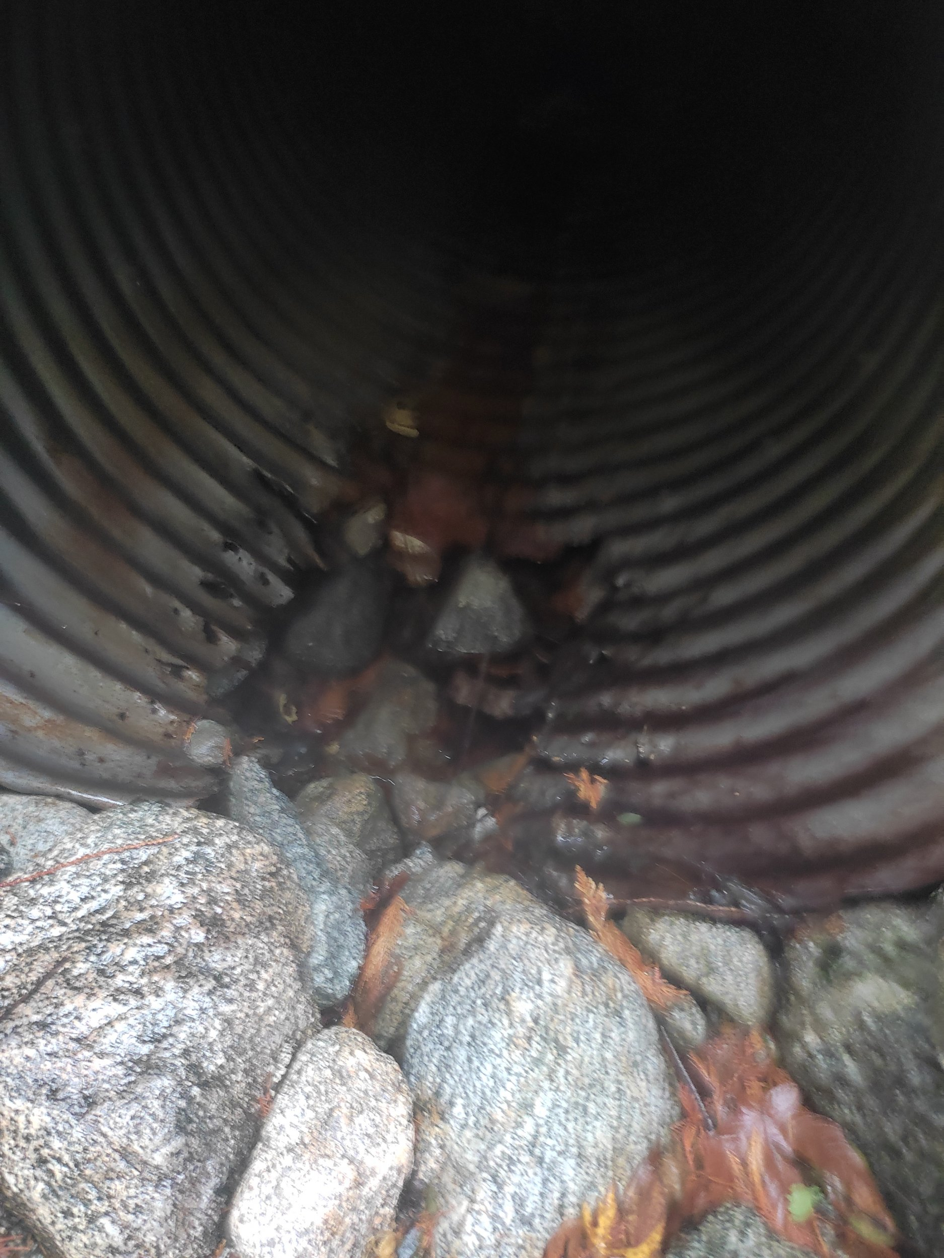

I've seen concrete placed on galvanized steel pipe. Good plan?

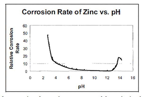

Well I don't know from personal experience, but I would be concerned about how alkaline concrete would react with galvanizing and potential rust. Concrete has a pH of 12.5 to 13 which is pretty alkaline and here's the corrosion graph for galvanized:
So it looks like we're right at the limit for increased corrosion. This is theoretical of course it may be just fine in practice.
I'm sure others can chime in here that have first hand experience

Why are you repairing it? Get it dry, hit it with cold galv, and it will last longer than you will.
   / How to repair steel culvert? Use concrete? #4
That would work temporarily to fix the hole on the bottom side of the culvert... But it looks like there's a line of rust starting form all the way down... If you keep repairing it that way, I would be concerned about it's integrity eventually... Long term fix is replacement..
   / How to repair steel culvert? Use concrete? #5
Depending on how much weight you are putting across it and if it was set properly (it appears from your picture that it was) that could last a long time. Start trying to fix it and you may cause it to rust faster. As log as you have water setting in the culvert at time, it will rust.
