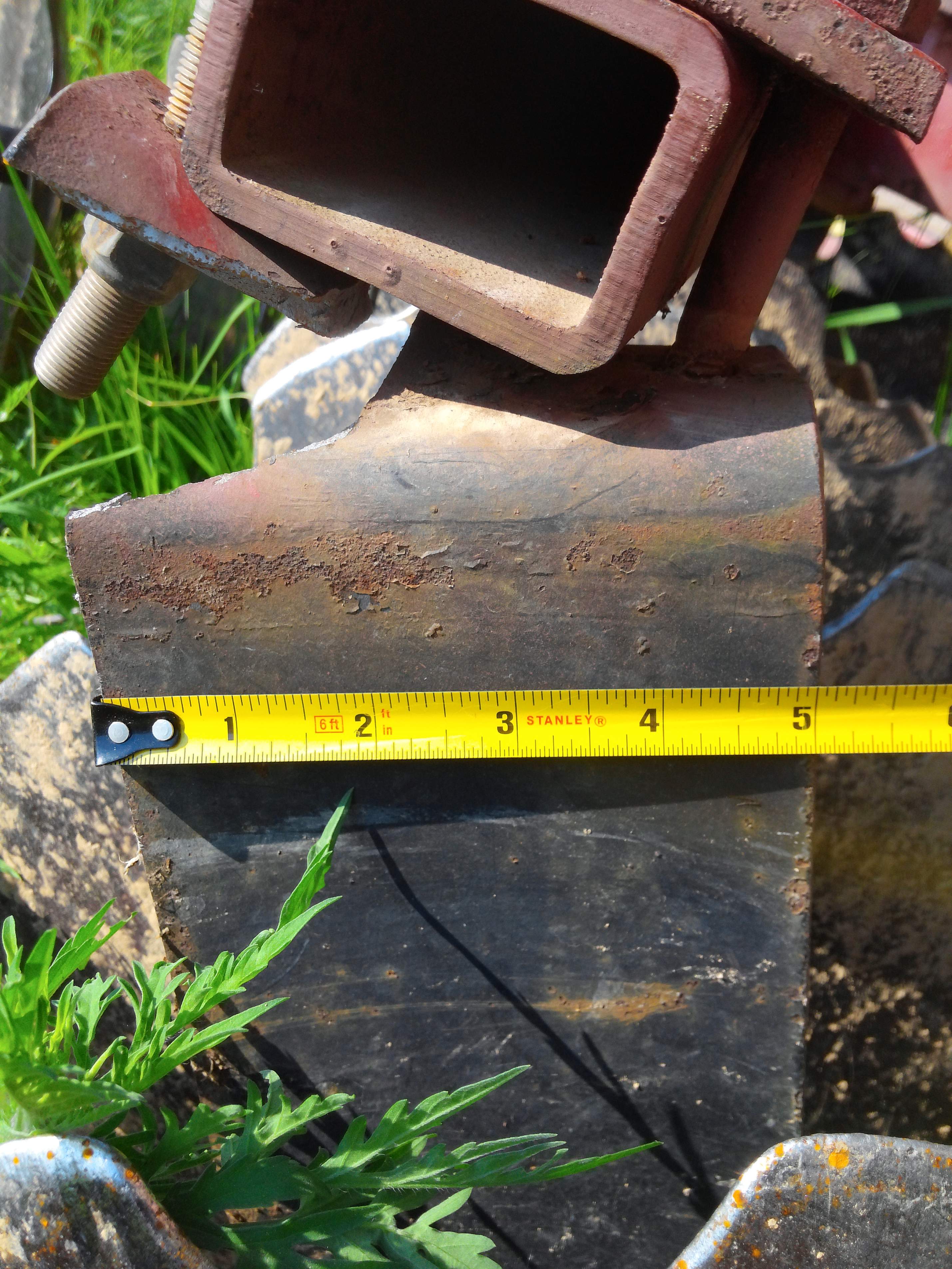

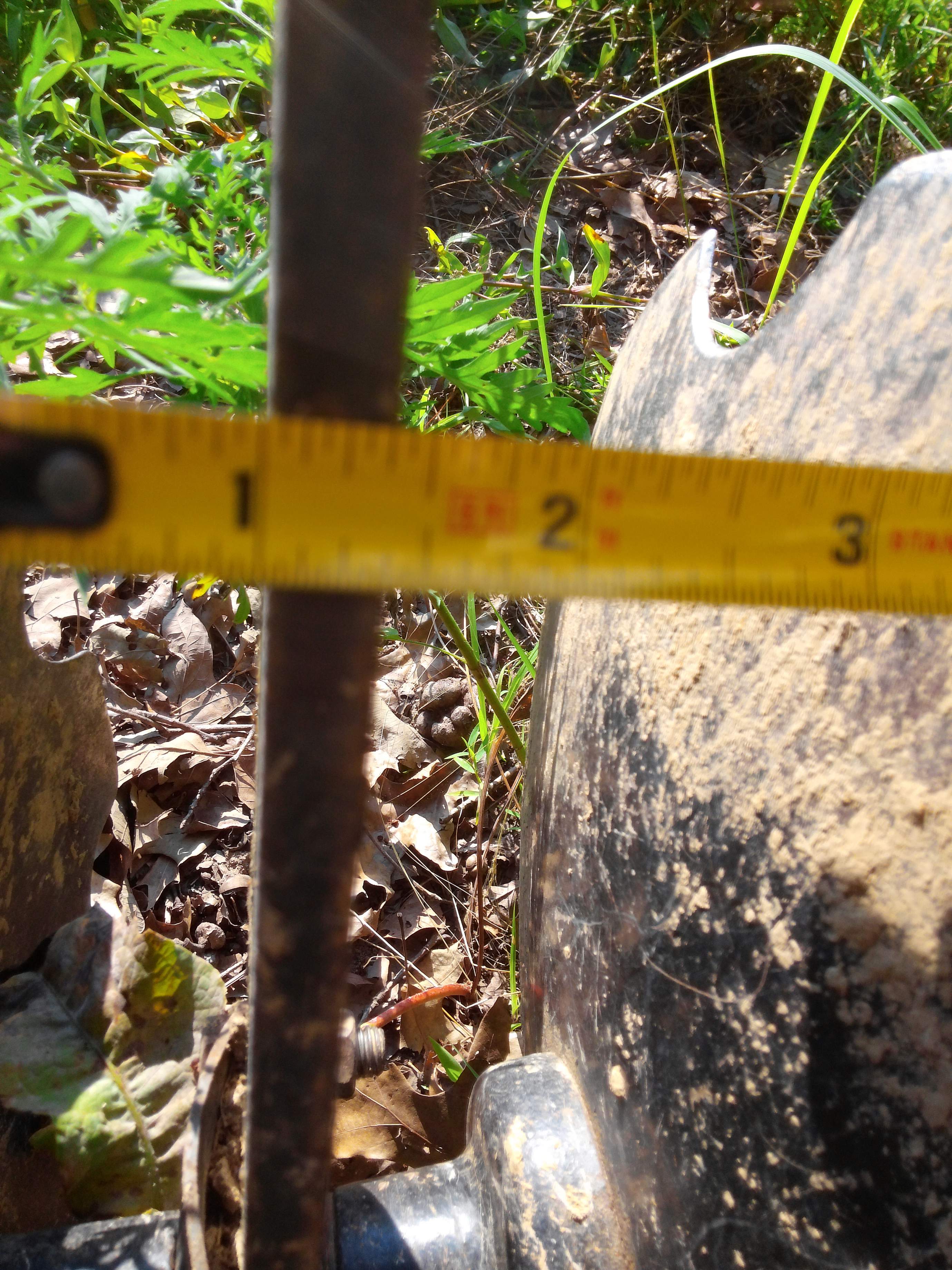

Hung the rear gang of my disk on a tree and broke the bracket. Have broken bolts before with smaller tractor but the 5500 jerk a knot in it!
Thinking of cutting off the top broken section and welding a angle the same thickness overlapped on the remaining bracket, Drill 2 holes and couple of new bolts (maybe not as hard this time) and bolt it back up.
Would a butt weld with gusset plates on each side be stronger?
Also, rod size and suggested welder setting- Miller Thunderbolt.
Thanks In Advance for any suggestions!

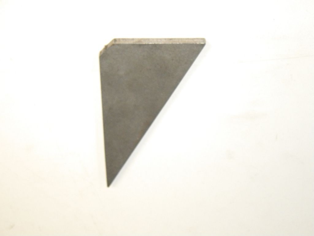

I would only put the gussets on the inside. Weld all the way around the gussets.
Put a 30-degree bevel on both plates. Gap using a 3/32 "drill bit. Use 1/8" 6010 at around 75-amps. Cap with 1/8" 7018 at around 120-amps.

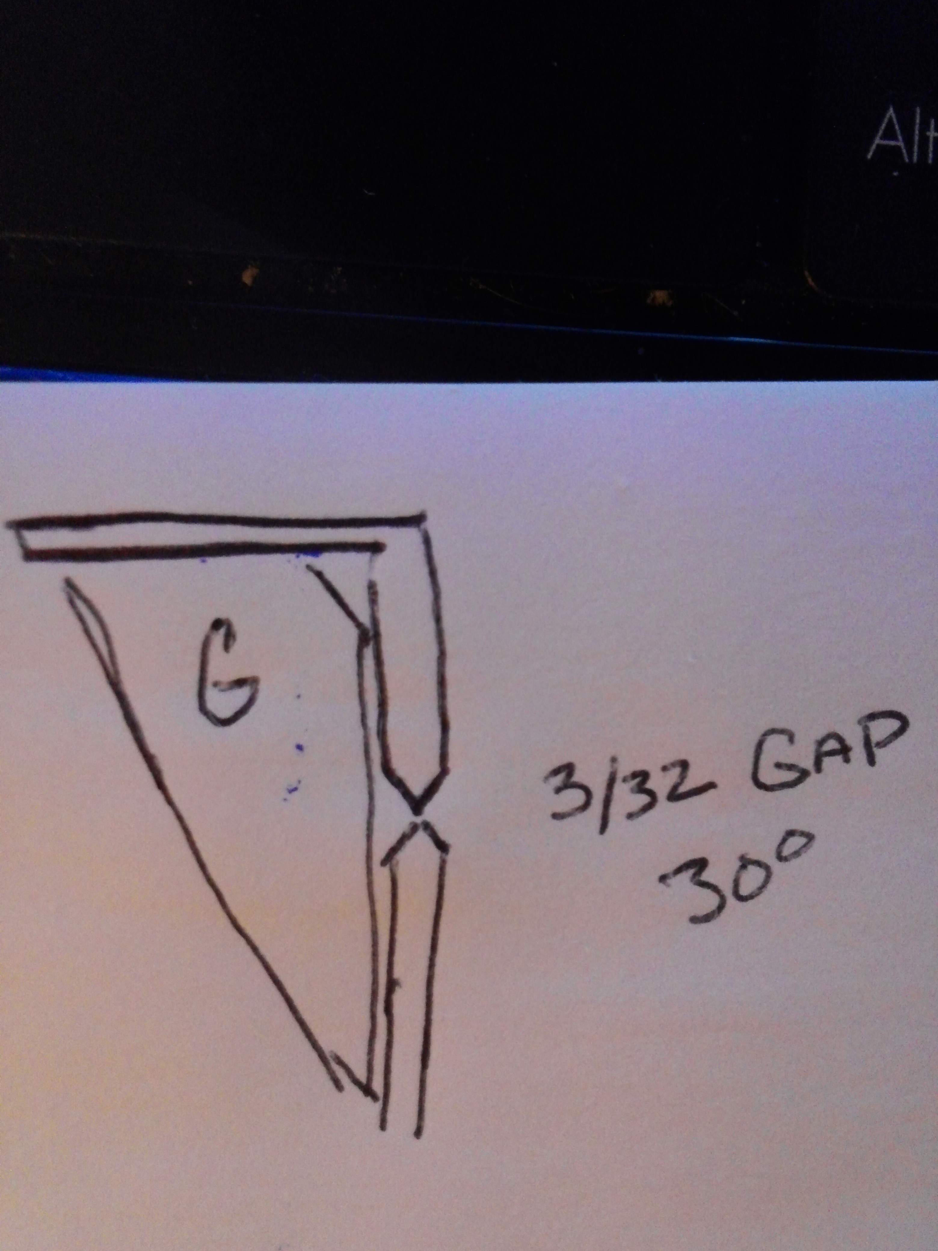

Like this?

I was wanting to 'patch' it but would rather spend the effort to make a good solid repair,
Thank you sir.
