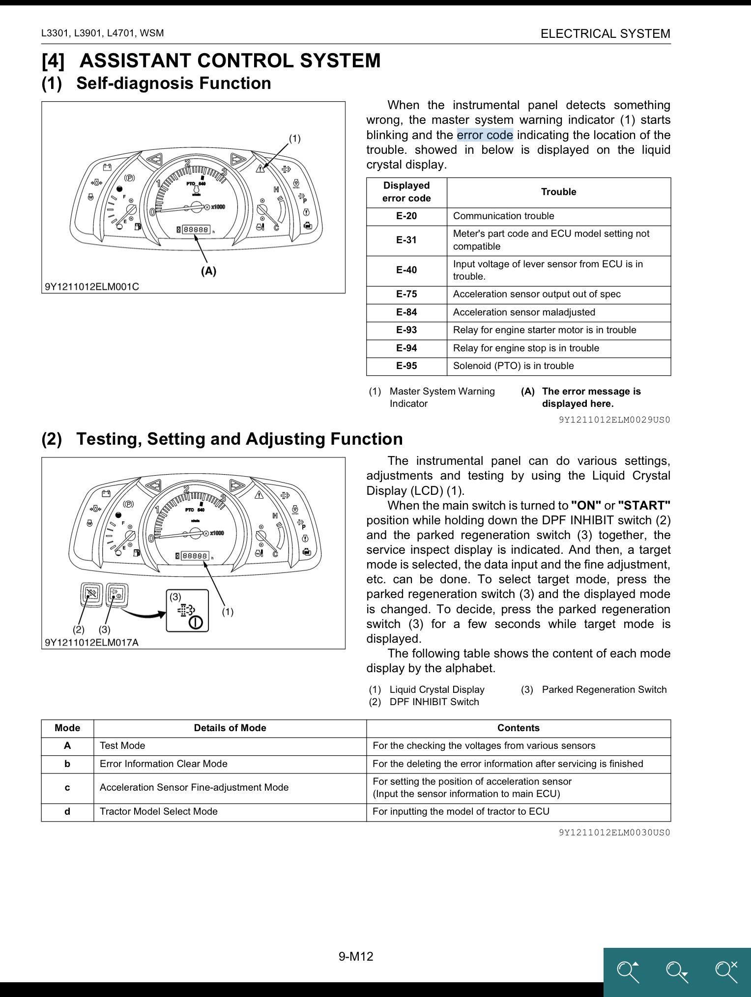

L3901 is showing E93, which is starter relay error. Service manual defines the error but seems to have no description of how to cancel the code. The machine starts and runs fine.
I had to remove the instrument cowling to install a USB power port. Apparently turning the "ignition" on (to test the USB port) without the relay connected is not to the liking of the computer.

TBN's ongoing picture viewing problem is getting frustrating. In case the op can't see the WSM page I posted above, it is in the electrical section, p. 9-M12
A summary is:
Key in on position while holding down the "DPF Inhibit" switch and the "Parked Regeneration" Switch together, will show the "Service Inpect Display". I suspect you press and hold the buttons first, then turn the key on. Not sure though.
Cycle through "Target Mode" A-D by pressing the "Parked Regeneration" button. Select the mode of interest with a several second press of the "Parked Regeneration" button when the mode is displayed.
A = Test mode, for reading various sensor voltages
B = Error information clear mode
C = Acceleration sensor fine adjustment
D = Tractor model select mode
The WSM doesn't go any further into the menus, so I assume the display will indicate how to make changes, or clear the codes. Likely with the same two buttons previously used.
Good luck.

Thank you very much RjCorazza. The images came up fine for me, but I appreciate the text effort.
So I tried this, and it worked, but slightly differently than what the manual suggests.
1 - Press and hold the 2 DPF buttons simultaneously and turn power ON.
2 - Indeed, "A" was displayed, followed by "b", "c", "d" (yes, my capitalization is correct) with each press of parked regen.
3 - when it was displaying "b", I pressed and held the parked regen and the system emitted a loud BEEP and displayed "PUSH". Well <ahem> that's not very informative as to what it wants me to do. Sweet baby Kubota, I love ya, but I aint pushing ya, that's for sure!
At this point I tried pressing the parked regen again, and nothing. Then I cycled the power and the code reappeared. I repeated this whole process several times with various guesses at what the pooter meant by "PUSH" until I tried simultaneously pushing the DPF and parked regen buttons which caused it to display "EXIT". Uh oh, that looked frightening. So I once again cycled power, and the code was now gone.
So, apparently the required steps are 1) press and hold both buttons while turning power on and look for "A". Press parked regen to get it to display "b". Then press and HOLD parked regen until it beeps (quite loud beep, startled me first time) and it should display "PUSH". Press both DPF buttons simultaneously for 2-3 seconds and it should display "EXIT". Now power off. At this point, you should be able to power on again and the error code should be gone.
Thanks for your detailed help. I hope this helps someone else.....

Tried all these solutions, multiple times and tried holding the buttons down longer, etc., but nothing changed and never saw "A", just continued Error 20. Finally pulled the main ECU 5A fuse and replaced it with the spare... It started right up and code went away on it's own.
A little background... I've had the tractor for 9 years, about 680 hours on it. Within the first year I had it die on me, while mowing and I thought I'd ruined my new tractor. After letting it set a while, I came back and it started right up. About a week later, I hit a stump with my rotary mower (brush hog) and it died again and wouldn't start. Google search and found the HST position switch might be a problem. I tried for some time to center it and eventually jumpered it and have been running that way for about 8+ years without issue.
Recently, I ordered a kit for Top/Tilt hydraulics on my 3 point and I was cleaning it up to take it in for the upgrade. I remembered that switch issue and decided to see if it would work, so I wouldn't catch any lip from the service guys. I plugged it in, started the tractor without issue, but as soon as I moved the HST forward/reverse lever, it died and gave me the Error 20. That's when I started looking at this forum. Eventually checked the fuses (which I should have done first) and found the blown fuse. Seems that something in the HST switch is pretty screwed up, because I can only run it with the jumper now. Just thought I'd pass that along in case someone else has a similar issue.
Thanks for the help guys!! Happy tractoring!!
