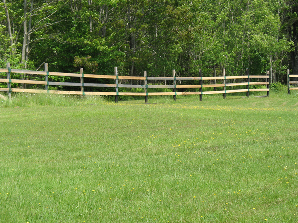

I used a story board pole. Vertical piece of board with measurements for 3 rails. It rested on the ground and marked the heights.
I towed behind garden tractor a trailer with generator, compressor and air nailer (3.5" nails) along with other tools...
I would stand back and check everything as I went along. Top rail gets capped with 1x6 board with 1/2" overhang over posts.
Good luck.
Lloyd
PS: I tarred tops of posts plus added a piece of roofing felt/tar paper before adding cap rail.
