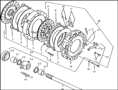

Since you have the cover off,look at a drawing of clutch assembly to identify clutch disk,tie clutch pedal down and use a large screwdriver to pry disk loose. Never put any kind of oil or other solvents on the clutch.
If you are able to start in gear and drive around as George suggested,having a plow that can engage the ground will help with breaking it loose. If you are unable to start in gear,towing in gear with another tractor while holding clutch down might unstick it.
   / How to tell if clutch is stuck? #5
I think it will be impossible to visually see traction clutch disc looking through a clutch housing inspection hole because PP(key 13) will be blocking view of clutch. Sometimes one can tie/block down clutch pedal,start engine then get unit to operating temp clutch disc will come loose from flywheel or PP. Spraying clutch/PP assembly with brake cleaner might help.
