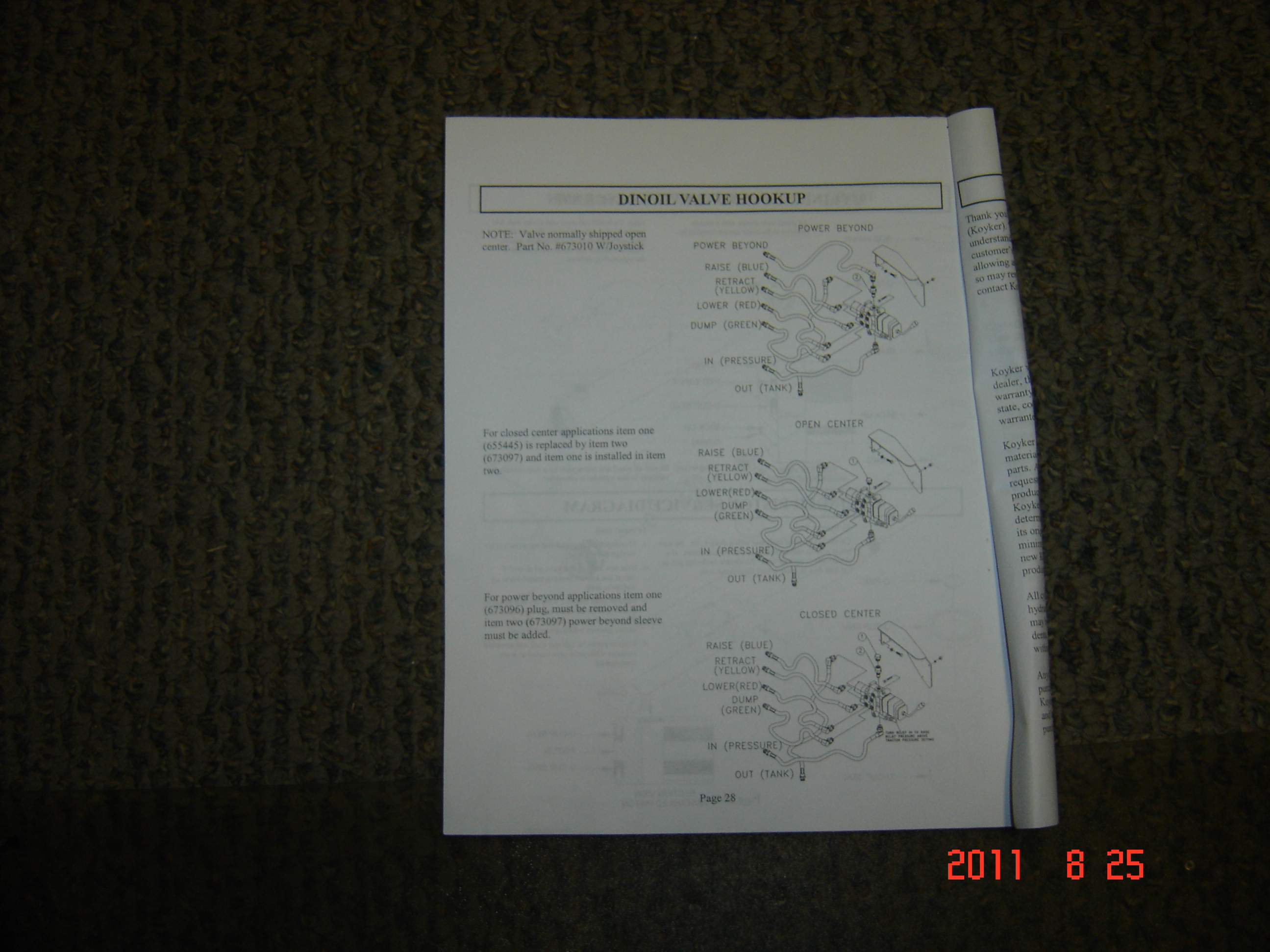

my loader valve has a PB port. The way the Hydraulic lines connect on this tractor will I be able to use the PB port & still be able to operate the rest of the Hydraulics on my tractor ?:confused:
See pics of how loader lines are connected to loader valve
The High Pressure line is cut and routed through my loader valve ( High pressure) & out ( H.P.) for the rest of the Hydraulics on the tractor to operate.The High Pressure then (I assume) goes to the sump & returned on the suction line ( all tractors may operate like this I don't know) The current loader valve has a PB port which is plugged. The loader valve manual states, if I use the PB port it changes the loader valve from open center to closed. Do I need to keep the valve open center so the rest of my Hydraulics will operate ?:confused:

On the diagram it shows Valve is shipped open center for closed center applications replace item 1 9which is the plug in the PB port0 . with item 2 which looks like a fitting and a hose for PB

a pic of the manual. Hope you can read it.

Yes, I can read it, and it says that the valve comes as open center, and if you want PB, to purchase and install the PB sleeve.
What the PB sleeve does is to separate the main gallery and OUT port and lets the hyd flow pass downstream through the PB fitting for additional valves or just to 3pt.
The cyl's expended fluid only goes to the OUT port, and most times the out ports go to tank.
