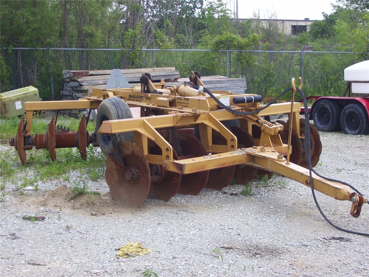

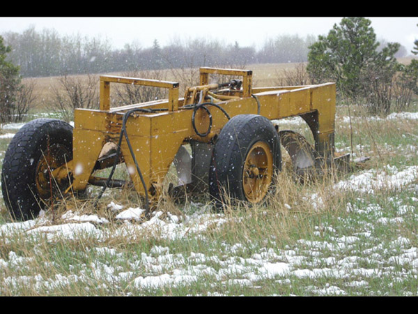

I'm sure a heavy Rome type Disk behind a D6 or a proper one bottom brush breaking plow behind a D6 would do the best job. These were the type of implements I have seen used to break newly cleared brush land. Quite a few of the disc's were behind a D9. But this type of equipment is probably no longer available.:D
