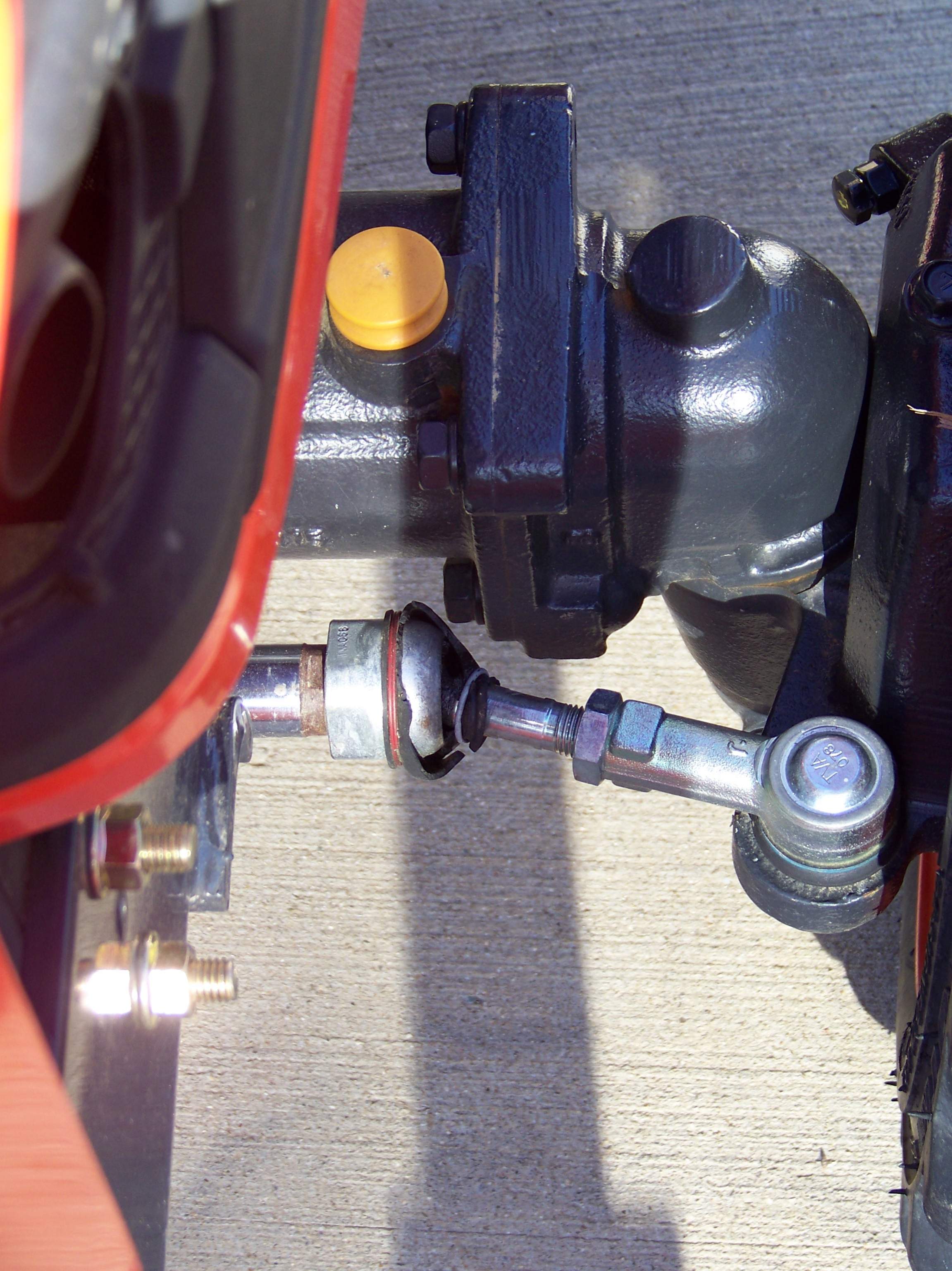

While looking over the BX today, I noticed this...
There's what I'd call a ball-and-socket joint exposed because the fairly flimsy rubber capsule surrounding it has been mostly torn away. Damage from some serious bush hogging while reclaiming some land is my best guess. Not really sure how long its been like that.
How worried should I be? What's the best course of action?
Many thanks,
Lost

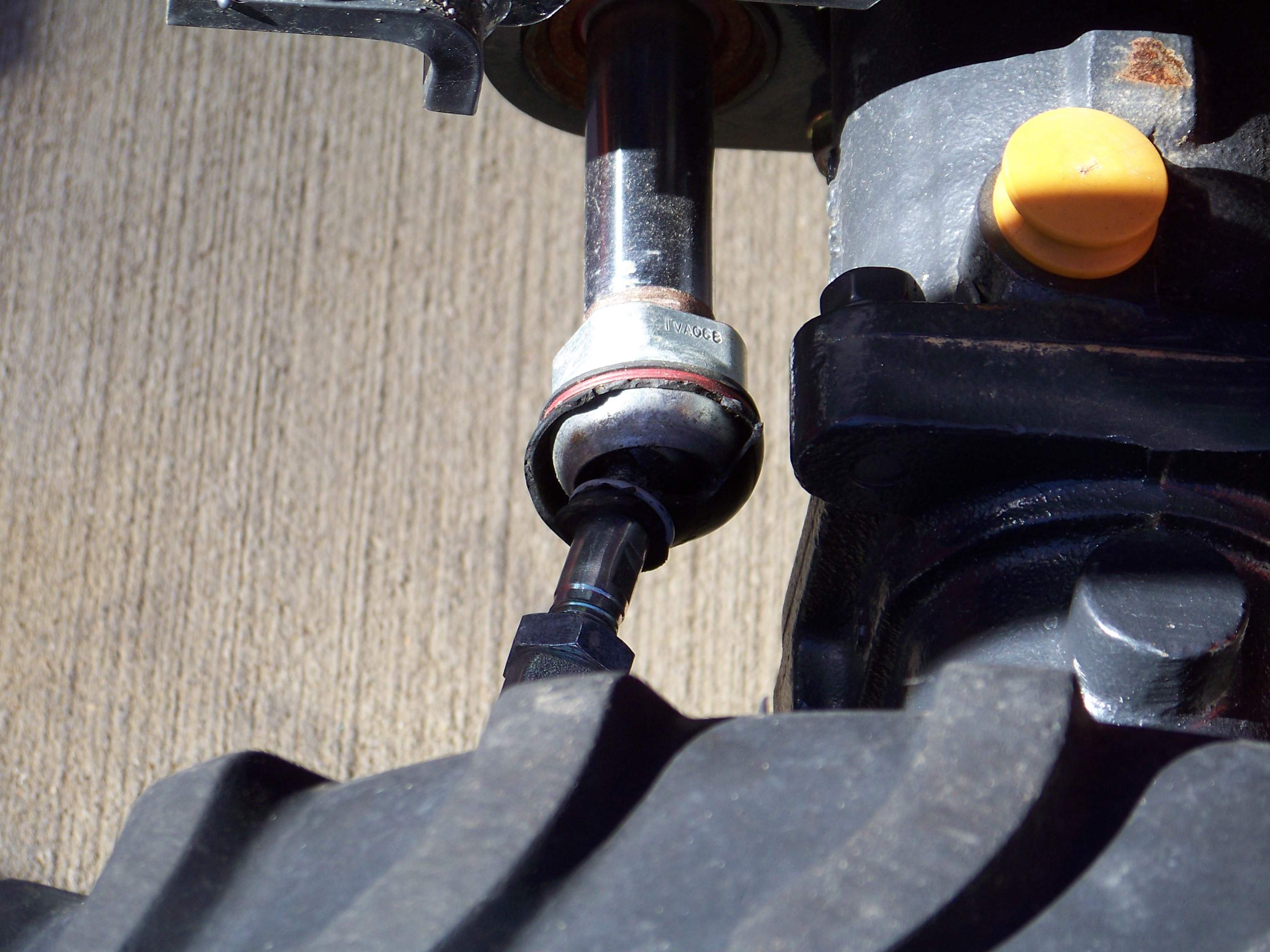

Here's a pick of the opposite, "good" side.

If your not concerned then keep it greased on the outside and let it go. If your more concerned then see your dealer to get a new boot and replace. IMO replace will be less expensive over the long time.

I wouldnt worry to much about it. I used a old inner tube and cut a piece out of it and used baling wire to hold it on. Its just to keep the dust out. But then again ducktape and baling wire and u can fix anything. :laughing::thumbsup:

the dealers don't just have the boot so mine have a bike inner tube with wire on them now with 2nd wear layer over 1st layer

Just ordered a replacement boot for my L4400 that I tore open while Brush cutting. I will install it myself and it was $14

The only way to get that from Kubota is to buy the entire assembly (cant just get a boot). Might as well try to rig it up - if if breaks you would still just need to replace it.

My dealer just ordered in a pair of those boots for our L3830, $17/each, so they are available (at least for some tractors).
Once they are installed, I am going to make a secondary shield out of rubber (1/4" bedliner) to put in front of and extend the steel guard. That way it will flex when it gets bumped into, but it will keep thorns and brambles out of the steering gear.
