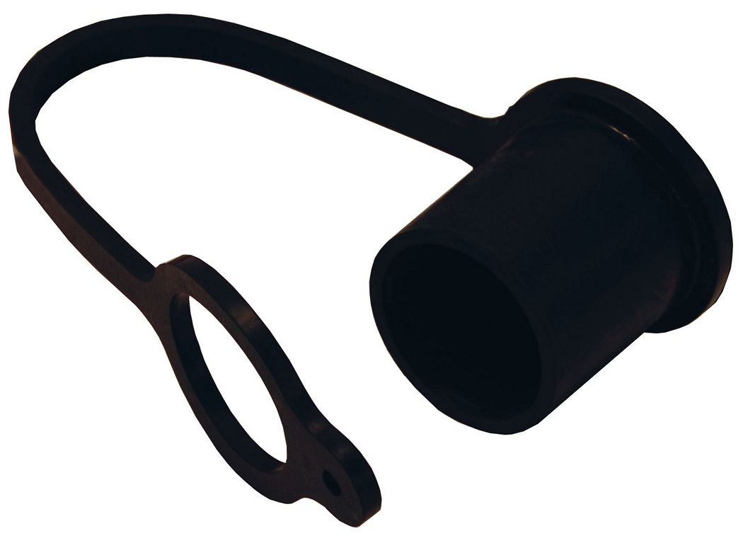

Can you screw on a plug or cap to the real female adaptor?

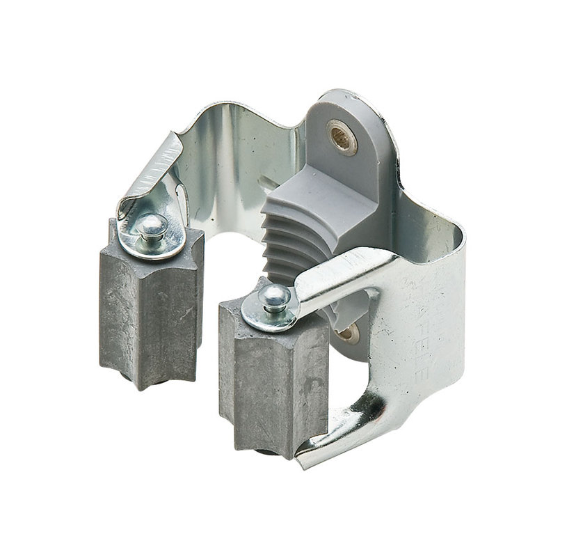

I would put a dust cap on it and make a bracket or use a broom holder, to hold it out of harms way.
