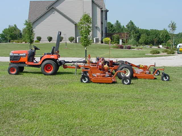

I think everything in your package sounds good,although I would recommend a little bigger Finish Mower...

Re: How\'s this Package?
mreeter,
Great looking rig you have there and a beautiful homestead!
Let me know the next time you paint the house. I want to get some Sherwin Williams stock just before you purchase the paint!
As for my needs, anything above 60" starts getting too cumbersome around the numerous trees and obstacles in the yard. Anyway, to go larger than 60" on a BX would require a rear finishing unit - and that would slow me down and cause loss of maneuverability. When it comes to mowing, I want to get it done reasonably fast with good quality. When it comes to the other stuff, l'm in no hurry - it's just play anyway!
Thanks
R
   / How's this Package? #10
Ret,I was just joshen ya,we have a 60" MMM under our BX and it does a SUPER job of mowing.
