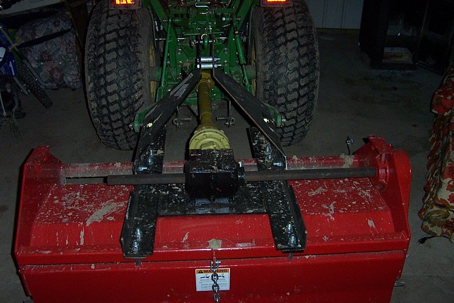

For the sake of posterity, here is a photo of my Howse 54" tiller. I know of at least one TBN member who has expressed an interest in Howse tillers. Thought I'd shoot a photo of the gearbox, slipclutch and reversable driveline while the top plate is off.
Since purchasing, I have had the chance to see JD and some other brands of tillers. In comparison, I am glad I got this tiller because the metal is thicker and the tines seem more heavy duty.
It seems to me to be a first class tiller at a reasonable price!
Buck

   / Howse 54" tiller #3
Re: Howse 54\" tiller
OK Buck, How much is rent on that puppy, and when can I pick it up?!/w3tcompact/icons/smile.gif I wish I had one. By the way how much was the shipping for the tiller?

   / Howse 54" tiller #5
Buck,
Did you order that from Norther Tool also or your dealer? The reason I'm wondering is looking at the picture (thank you!) and the catalog as well as the specs they don't appear to be the same. What am I missing here, wrong catalog or what?
BTW the idea of a reversable driveline is interesting, allowing for reverse rotation tilling /w3tcompact/icons/smile.gif.

   / Howse 54" tiller #6
Buck,
Thanks for the info. I've been looking at that tiller for a few months now but was a bit hesitant to order it because there wasn't much info on it. The price and features of this unit look hard to beat. Even with the shipping, it'll still be about $500 less than a comparable Woods unit I was thinking of getting. My uses for the tiller will be very limited, so I don't wish to spend more than necessary.
Do you have the exact Northern Tool catalog item number for this unit? It seems that Northern sometimes has different tillers available.
Thanks for the great information.
~Rick
   / Howse 54" tiller
Rick,
It is Item# 250188.
It seems to me that this is the -only- Howse tiller they carry. The rest are, I think, farm king. Notice the difference in features and weight/Length.
Buck
   / Howse 54" tiller
pcmem,
It is Item# 250188. I shot the photo with the tillers' cover off. Maybe that is why it looks different.
However, I did find that the item didn't come up on the on-line catalogue with the others. Definitely try a search using the item number above.
Buck
