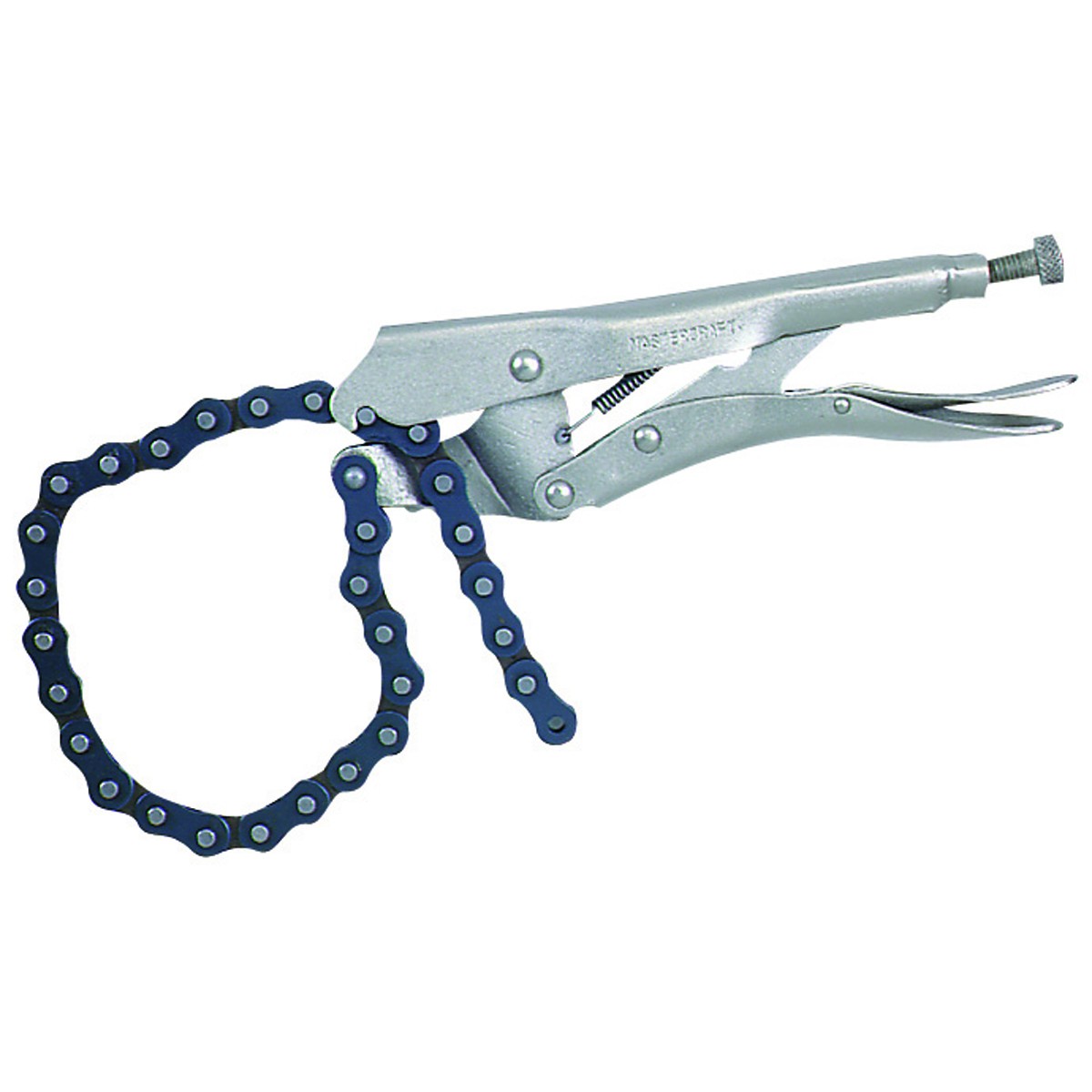

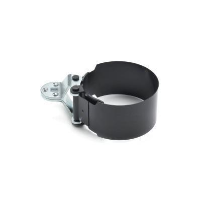

I used my Snapon strap wrench
but any thing similar will do. even really big channellocks
I would not use a chisel or drift unless you want to punch a hole. Which is a way to get it off too. Just drive the punch through the middle, and out both sides. then you have a handle!
