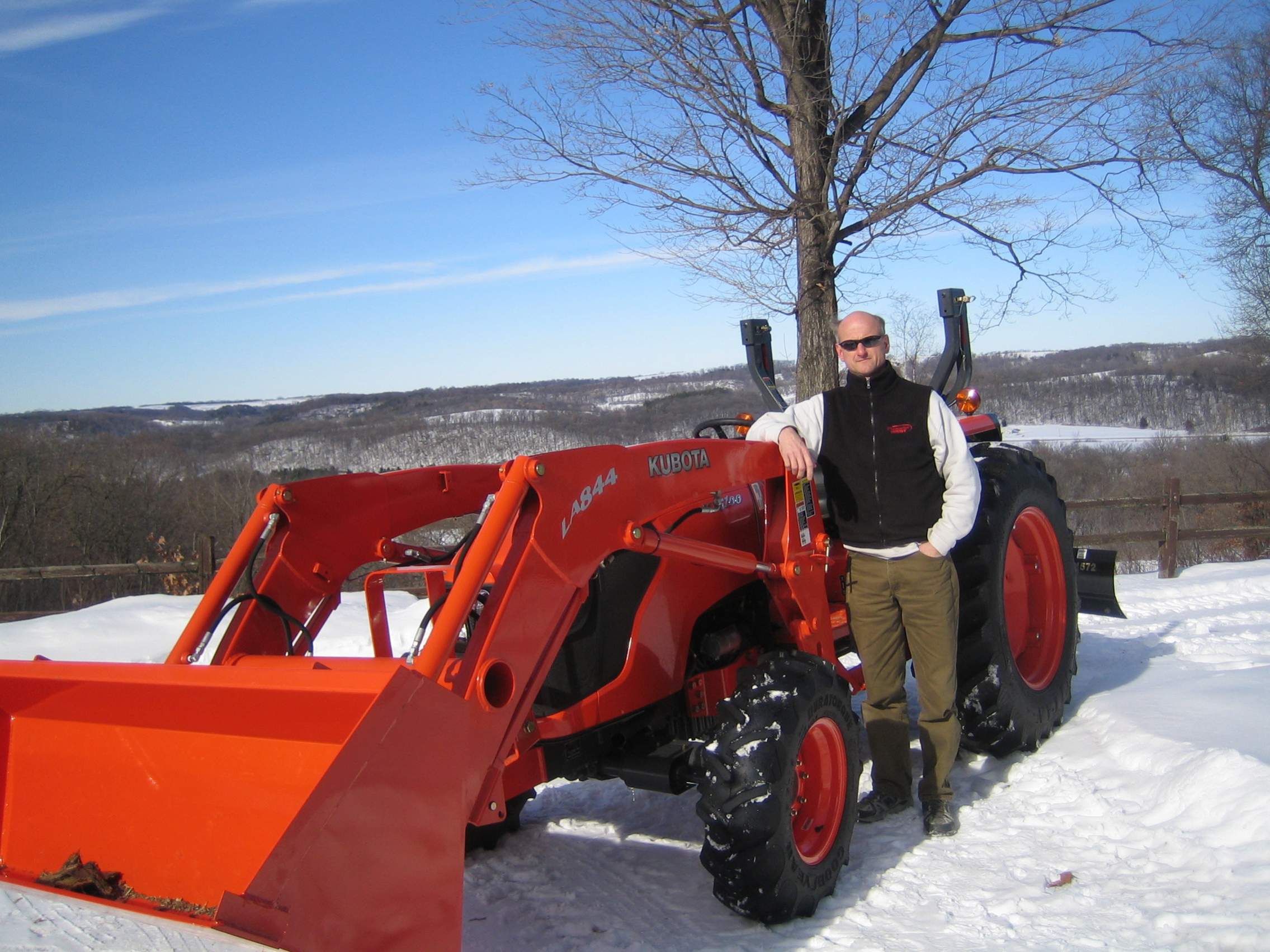

Hello folks - New member here and after 3yrs of lurking; I finally registered. Had a Kubota B7800 for last two years that I bought new. Last November I traded it in on a new MX5100. I attached a pic...
