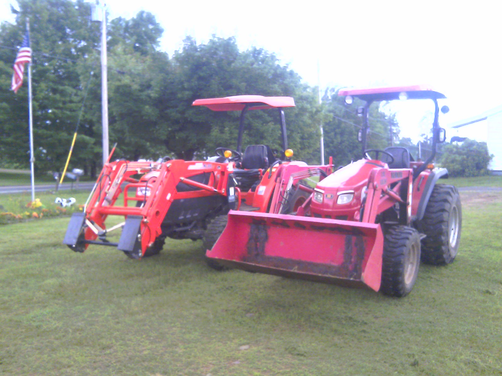

With a Hydro there is no clutch. You have 3 ranges. . .Low, medium and high range. Heavy pulling is usually done in Low range, Loader work for the most part and all other work, Medium range works good and High range is for transport.
Most Hydro's have 2 pedals on the right. Pedal on the left is forward and right pedal is reverse.Some have a "rocker pedal" with this style "toe" is forward and "heel" is reverse. The brake pedals are on your left side so using the brakes to help steer is possible, its just a matter of getting use to doing it with a different foot.
The best part of a Hydro, IMO is the ability to go quickly from forward to backward without drivetrain damage and operator fatuige. Great for loader work and rear mounted blowers. I am currently running 2 Hydro's with no problems what so ever. Hope this helps . . .John
