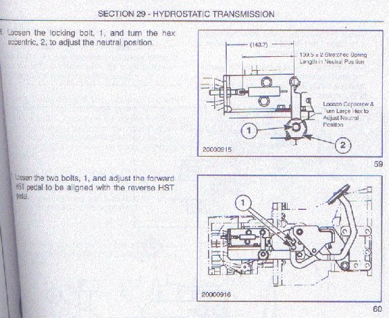

I've checked my manual twice, and I can't seem to find out if there is an adjustment for the HST pedal. When I leave off the pedal the tractor inches foward without touching the pedal. I greased the whole tractor thinking it would help, but I don't think the pedal is sticking. Is there an adjustment to stop this? My tractor is a TC21D. Thanks, any help would be great. Kent

There has got to be a way to make this adjustment. On my TC35D there is a a capscrew which secures another larger eccentric nut. You're TC21D is probably similar.
I scanned a page from my manual for reference. BTW be real careful when doing this. I greased my tractor and it caused the neutral position to slip. I started my tractor, put it is range II and it threw itself against the brakes (cause the neutral position had changed). Scared me pretty good as I was in the garage at the time.

paccoti, Thanks for taking the time to help. I'll try to see if I can adjust it today. I'll make sure I'm outside when I do it. /w3tcompact/icons/wink.gif Thanks for the warning.
