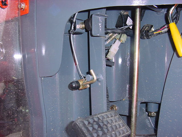

bending over to hitch that L shaped lever was becoming troublesome
   / HST pedal cable
#2

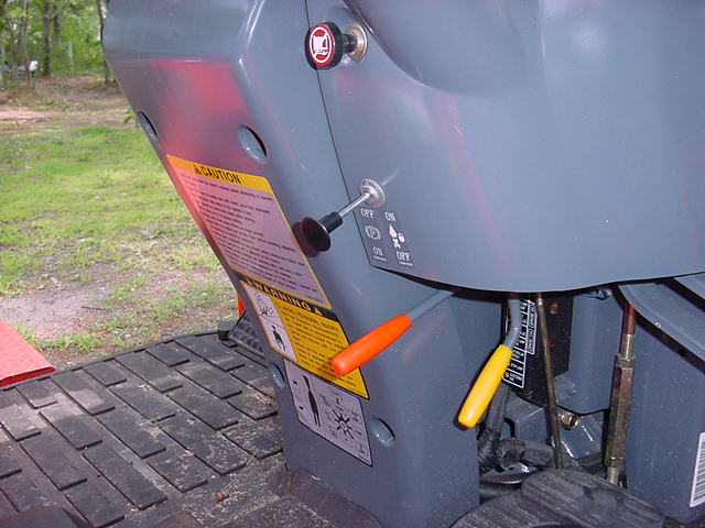

It is a simple $5 push-pull choke cable sold at my local Car Quest. It is routed over the steering column, tie-wrapped to the HST pedal stop and connected to the small lever with a hole I drilled in it. Knob doesn't stick out past the cruise control lever and is completely in when the pedal is released. Pretty slick I think!

I chose this location because my hand is already there to set the parking brake. It could be installed at any location with the proper length cable
