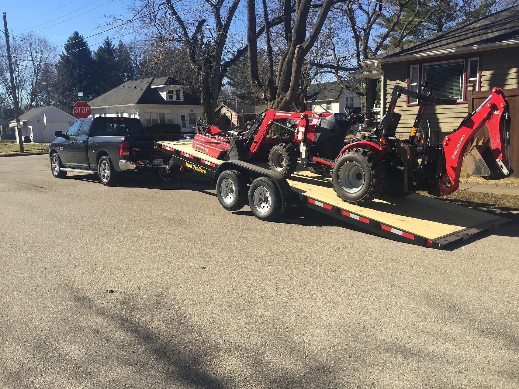

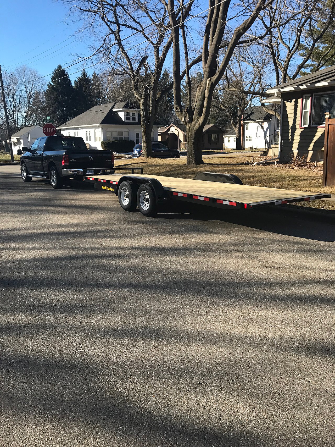

I知 looking for a trailer to haul my Mahindra 2538 FEL W/ backhoe. Will be pulling with my Toyota Tundra... don稚 want to messs with Ramps if I don稚 have to. Plus the added bonus of being able to load materials from the sides and utilize stake pocket sides is appealing.
I致e looked at the Hull tilt trailer online with either manual hydraulic or electric hydraulic tilt... for the price it looks like a great deal... plus good warranty on the frame also....
Hull is moving trailers like nothing I致e seen, check out their Facebook page...

Not sure which model you're looking at but I don't like a tilt trailer that pivots in the front and lifts the front wheels off the ground. I had one similar made by H&H in the same town as Hull. (might even be made by the same mfg.) I bought it new and after 10 years had to completely rebuild the suspension and all new brakes. A front pivot trailer like mine also has the axles mounted almost dead center of the trailer bed which could lead to trailer sway problems from not enough tongue weight. I never had that problem with mine because I always made sure I had plenty of tongue weight.
I'd go for the electric / hyd tilt for sure. Mine was a manual pump hydraulic tilt which got old real quick. Pumping that cylinder a hundred times or more to get it to tilt quickly wears out your arms. For about $600. I bought a 12V power hyd unit, cylinder and hose and converted mine to power up and gravity down within the first two weeks. Shortly after the repairs I sold mine and bought a 22' PJ model TF full tilt with power up / power down.

I love my power deck over tilting deck. I had a 16' gravity tilt that worked good, but was just to small. I looked at some bigger gravity tilt trailers, but ultimately went deck over. Gravity tilt load tractors better due to the low profile & resulting low angles. The deck over is a lot steeper, but I have no fenders to deal with. It handles loading others stuff over the sides better. No clearance issues with my wife flail mower hitting fenders either. I'd have gone with another gravity tilt if I was only moving my tractor. I went deck over because I move other stuff too. A hair harder to load the tractor on, but way easier for other stuff.
Ive seen some tilting frame trailers you jack up by a jack on the tongue. Not impressed at all. Time consuming & it puts all the weight on 1 axle when loading.
Gravity tilts are nice, but have ballance implications. The deck needs to be ballanced front & back so it tilts easy, so they pivot in the middle (and always between the axles). That means you can't put any weight on the back of the trailer & get a proper tongue weight. Most have a warning sticker on the back to that effect. They are easy to ballance though. Pivot is more or less center. So you just have to drive forward until the deck tilts down & it's ballanced. Drive forward a bit more & you get the proper 10-15% tongue weight.
