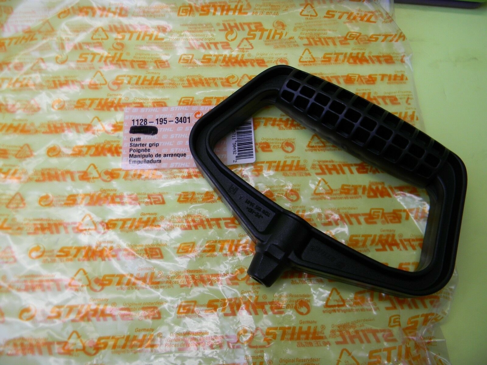

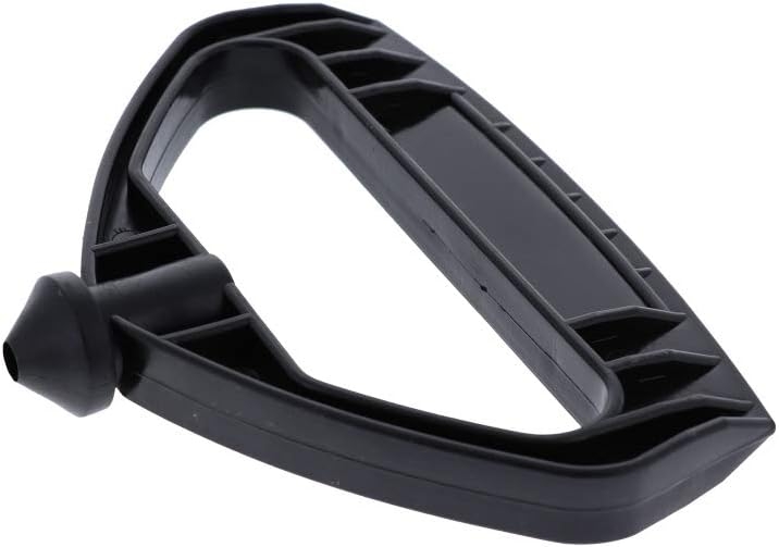

Cool. Pic of the one you said you got that was oregon brand?
I keep picturing the one with squared edges that can bite ya. If so be careful. Those have broken here before too.
Those are ones I pull off saws if come in on one and give away to a friend that uses them. I like the stihl ones for roundness etc.
