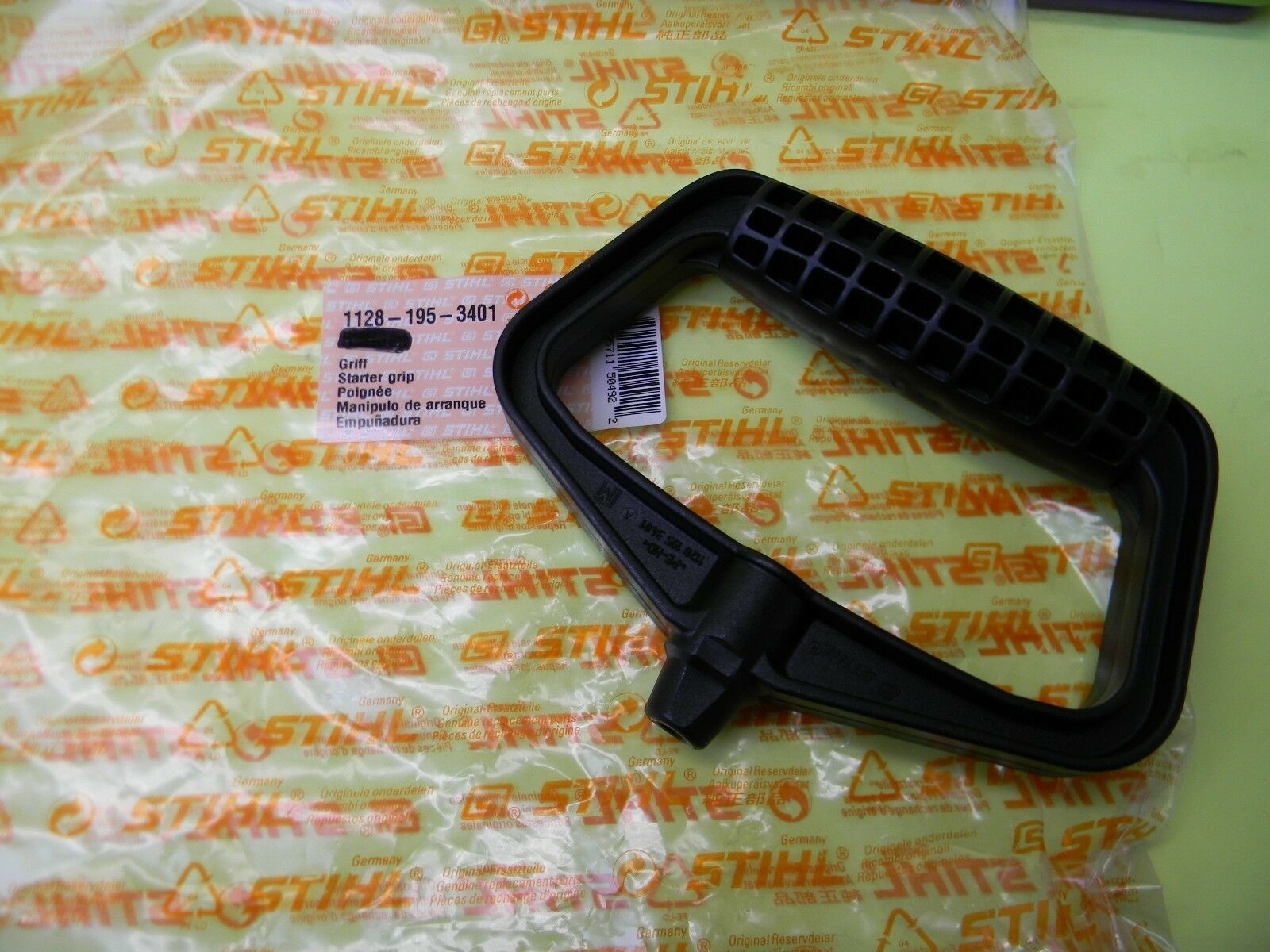

Put one of these on there to help you get a good grip and pull it over faster.
If that is the problem. I have put several on older folks saws.
It alone bought my dad several years of starting his saw. Till he had to go EZ start saw.

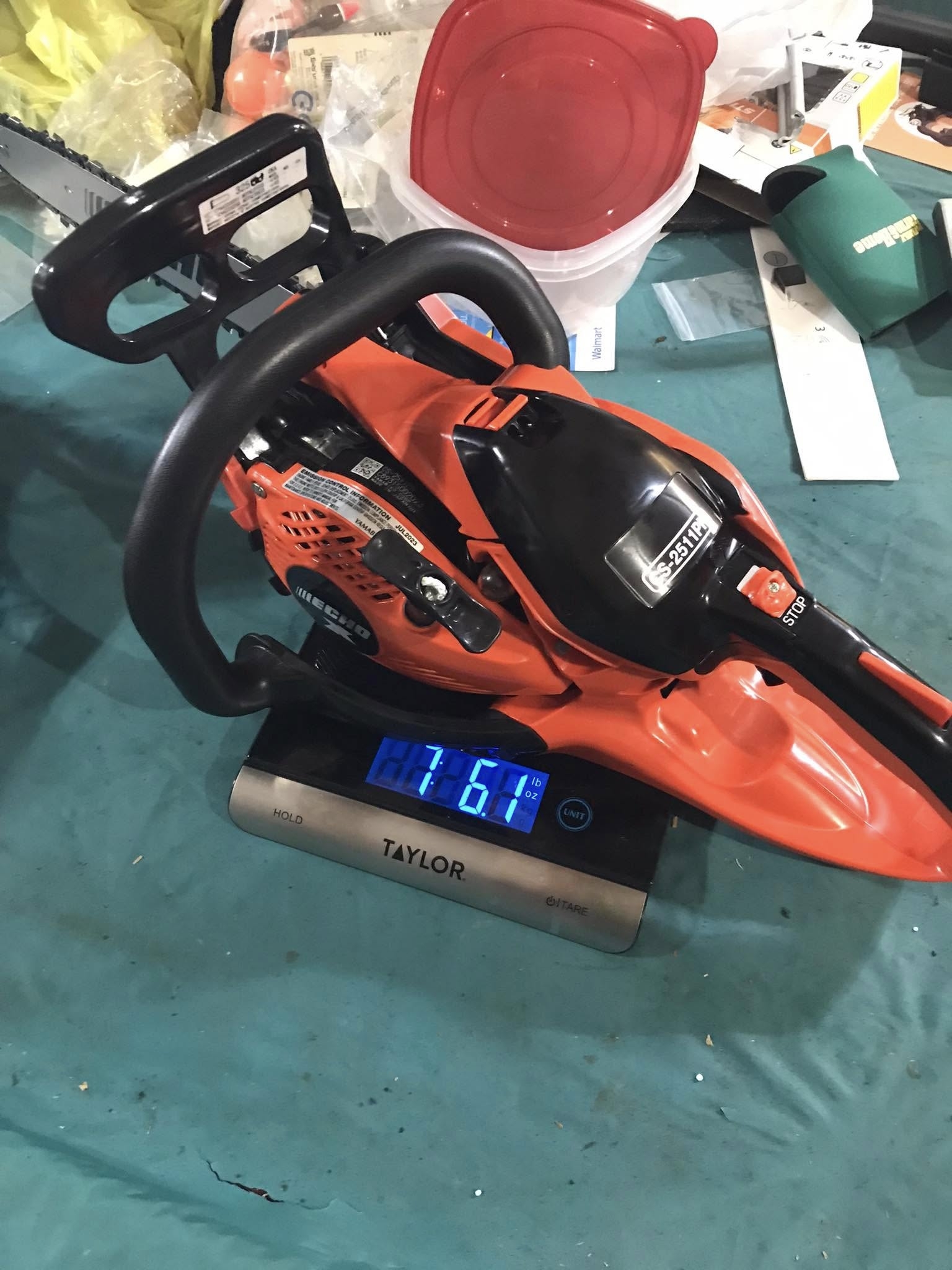

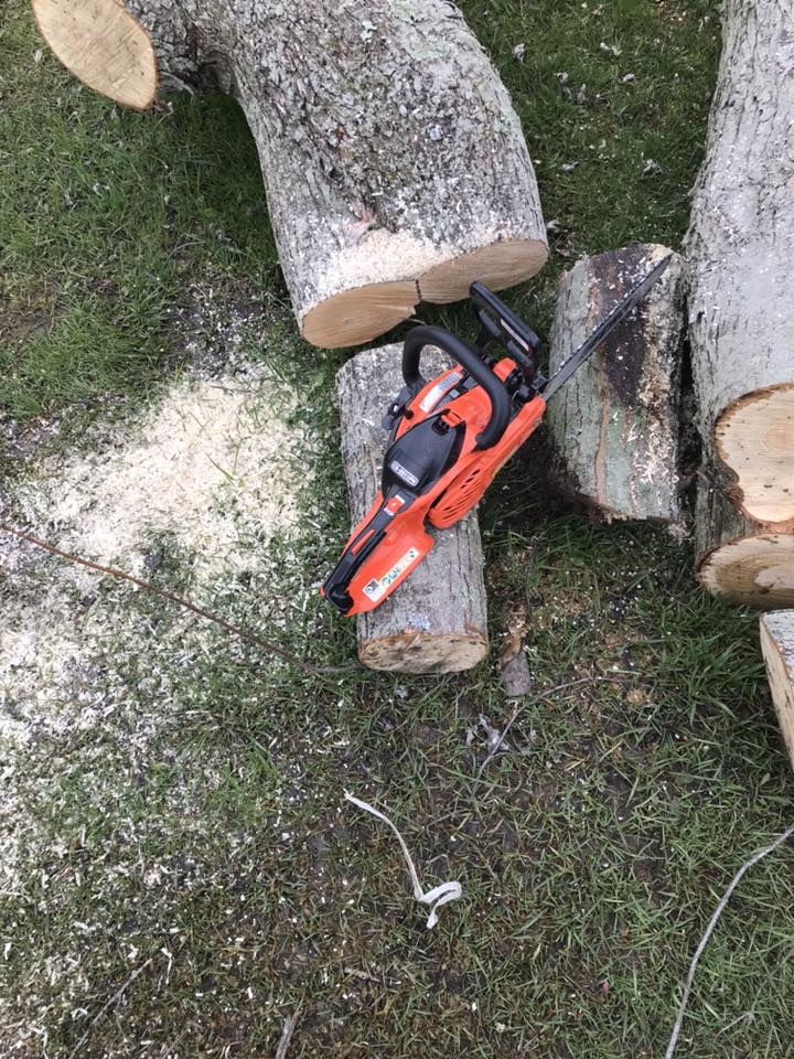

You're a prime candidate or an Echo 2511! I swear these saws punch way above their weight class. But ya aint cuttin 36" stuff with one lol
   / Husky 455 with decompression button #8

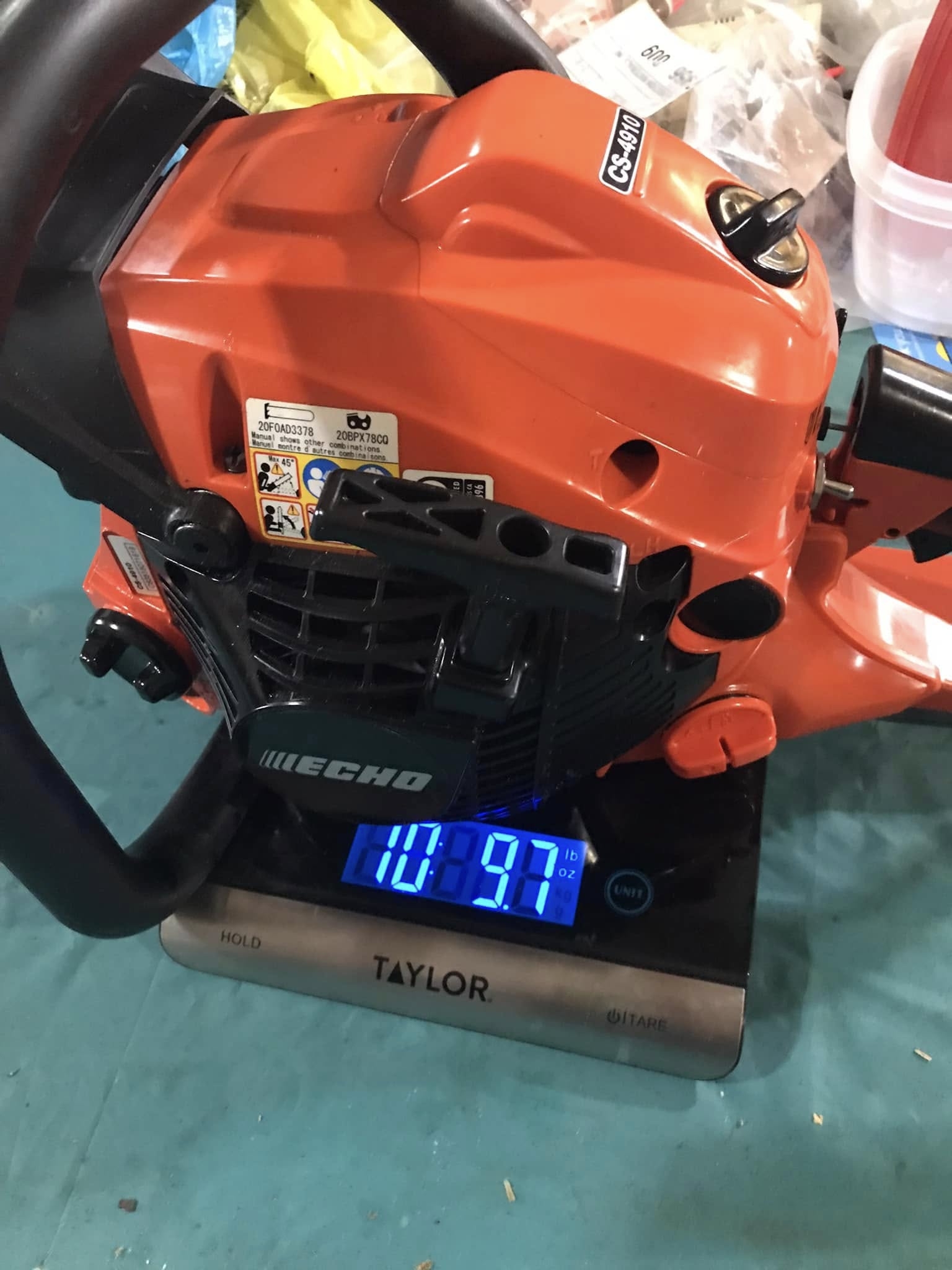

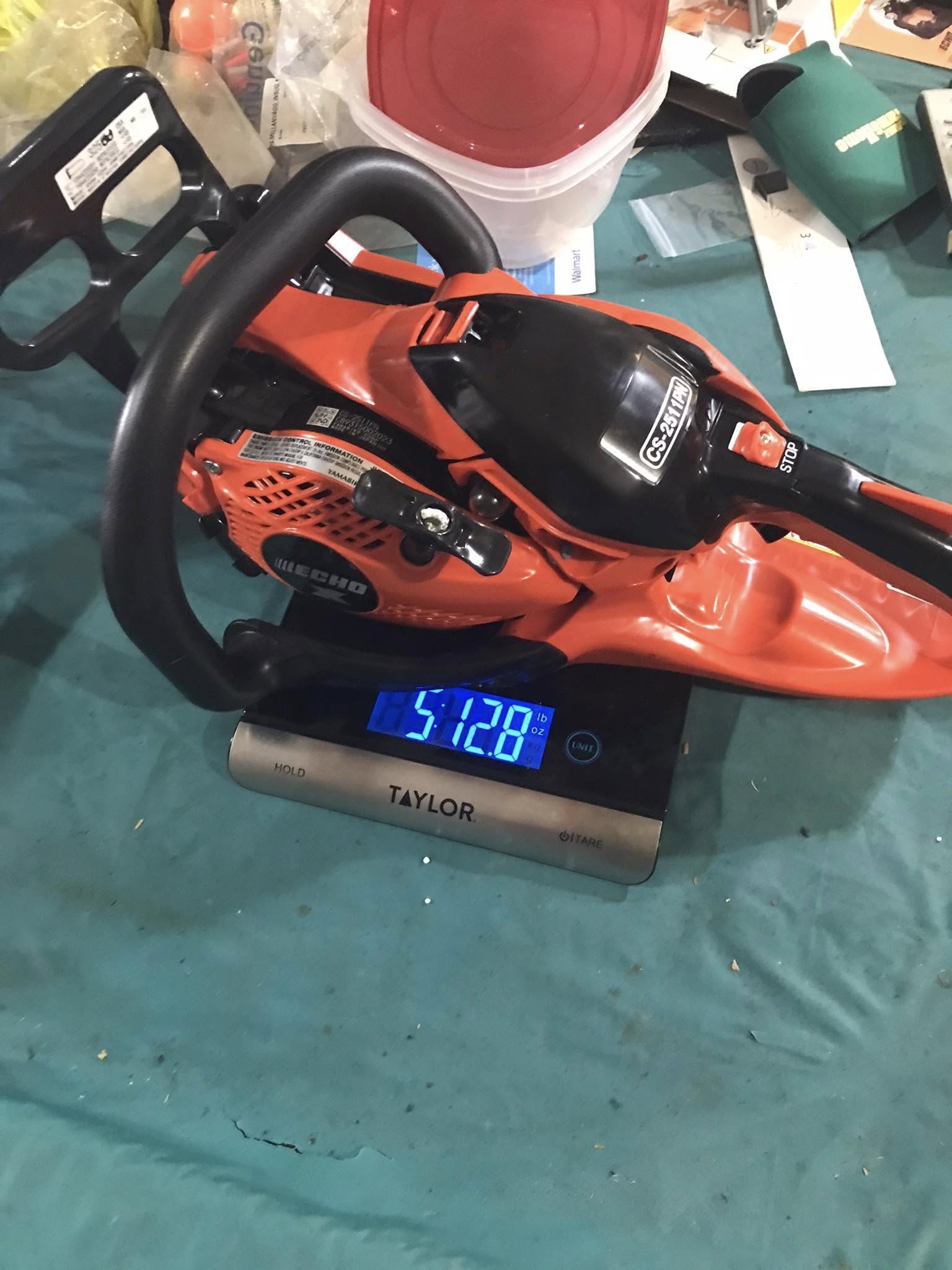

He is talking this little guy. I would get rear handle over top handle if doing lot of ground work. I have both.
25cc. under 6lbs PHO dry and 7lbs and some ounces ready to cut full both tanks. Spring assist starter.
Stock muffler holds them back from potential.
I love mine.

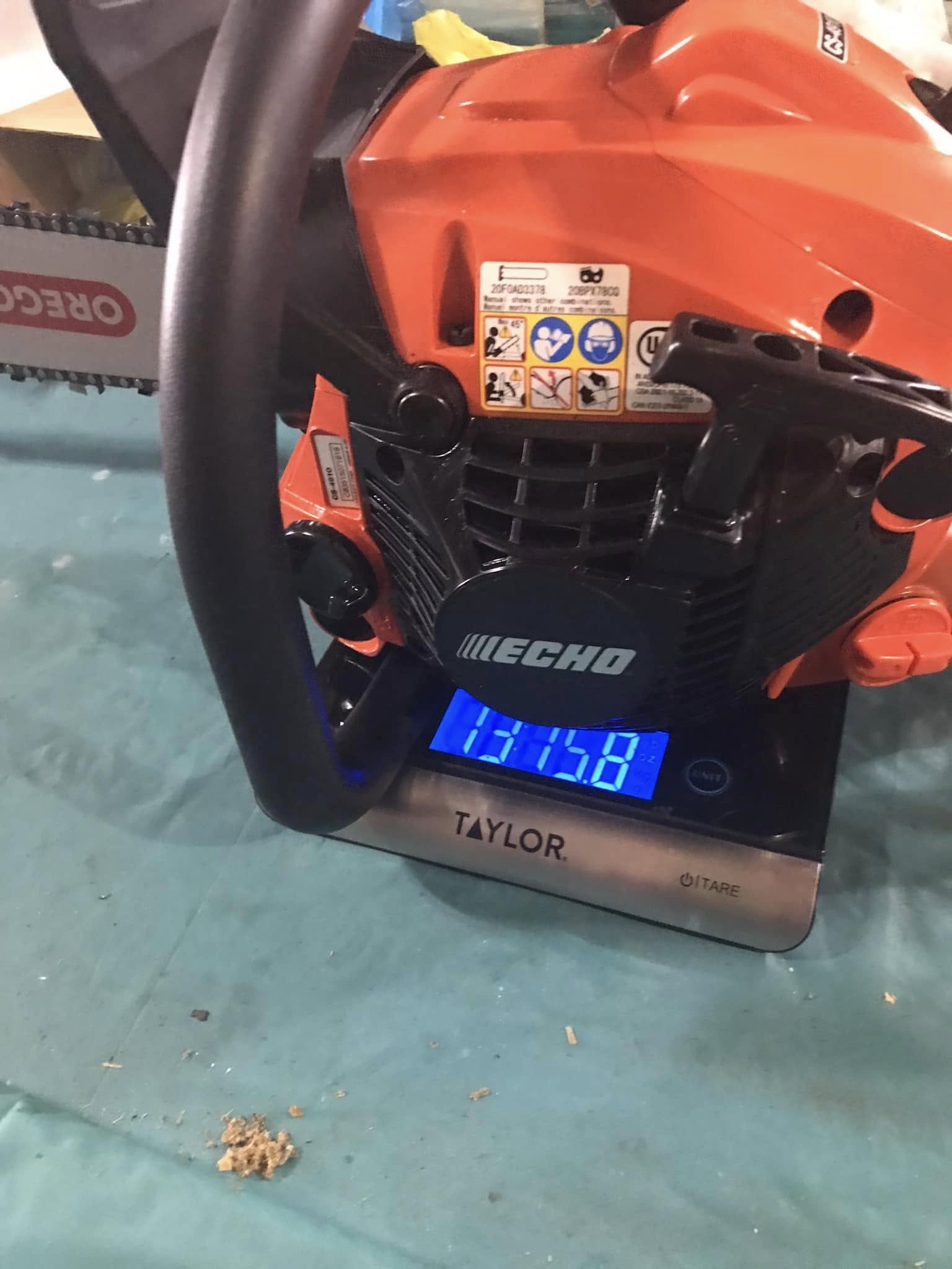

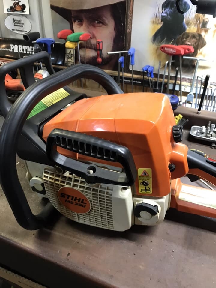

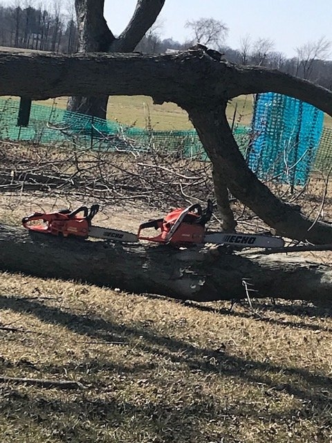

I also love the light for 50cc echo 501 with a decomp too. 10lbs 10oz PHO dry and under 14lbs ready to cut weight. But think I have a pic of 4910 one I traded. Stock muffler holds them back from potential
