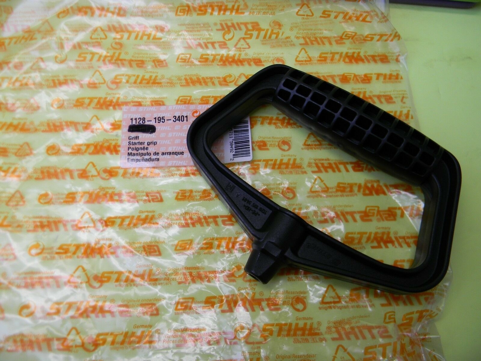

Age got my dad in mid 80's and fight with cancer. I ended up with his saw he bought new and couldnt start.
I got him a small easy start one and he got a battery polesaw for his uses.
I have had several 266's.
You might try this. It bought my dad almost 2 years of still starting his old saw. Cost like 5-7 bucks. Stihl makes the lightest and very nice and rounded with no sharpe edges like others.
Stihl 460 recuse saw D handle. Part number in pic. I use to buy them by 5 paks.

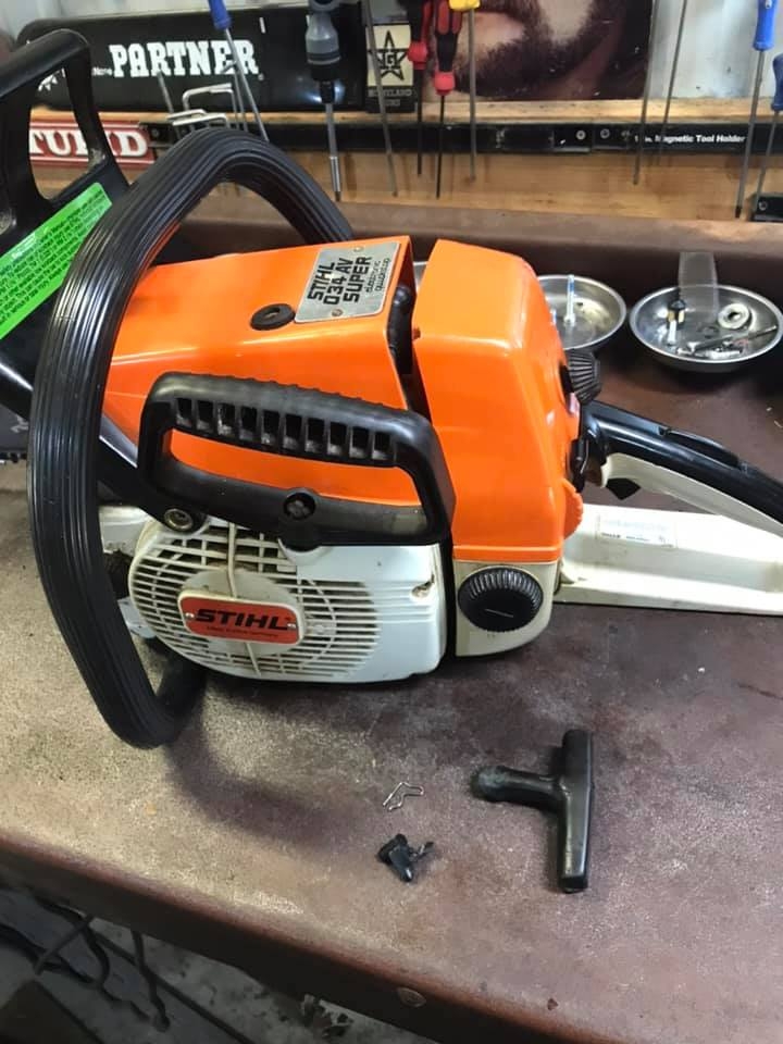

I just did a guys 034 super that has same issue. He is in 70's
Did it for another older friend on his 390 too.
Both love it.
   / Husky xp266
Great…just ordered one. Add said Oregon but close enough. Ordered new 3.5mm pull cord also. Might as well change both at the same time.
Thanks for the idea.
   / Husky xp266 #7
Aftermarket ones break. China has a copy of these and not near as good. Just so you know.
Never had the OEM stihl ones break to date. I ran them on race saws for cold start racing with alot of psi.
Just so you know if the one ordered isnt stihl and breaks on ya. Get the oem one.
