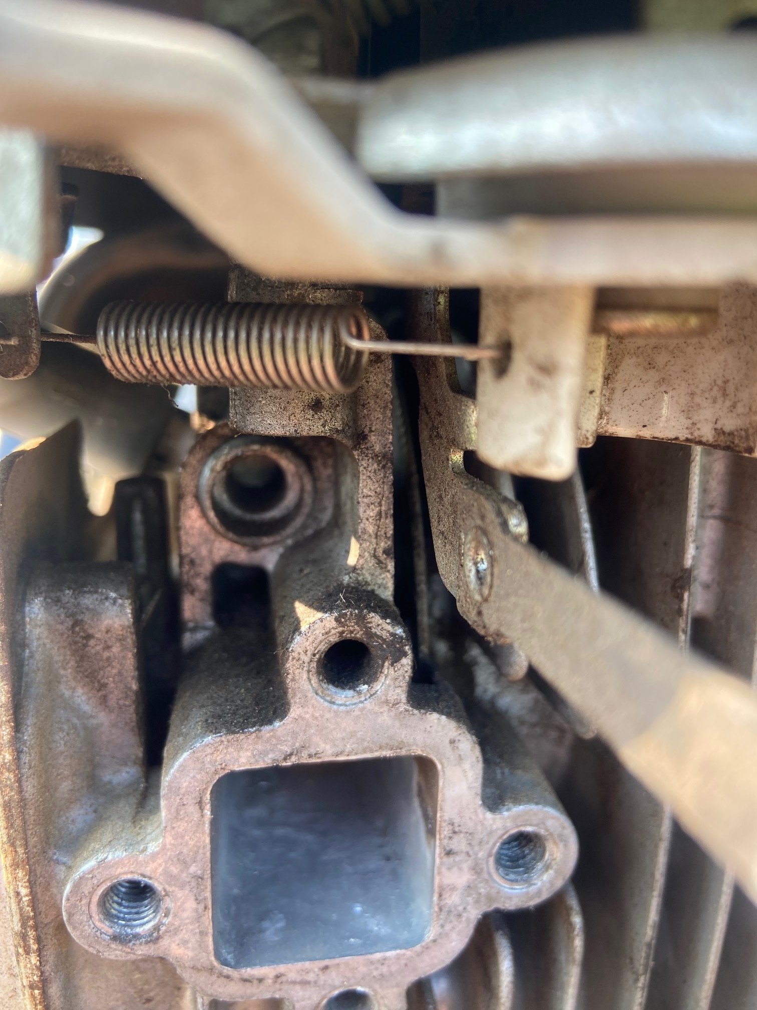

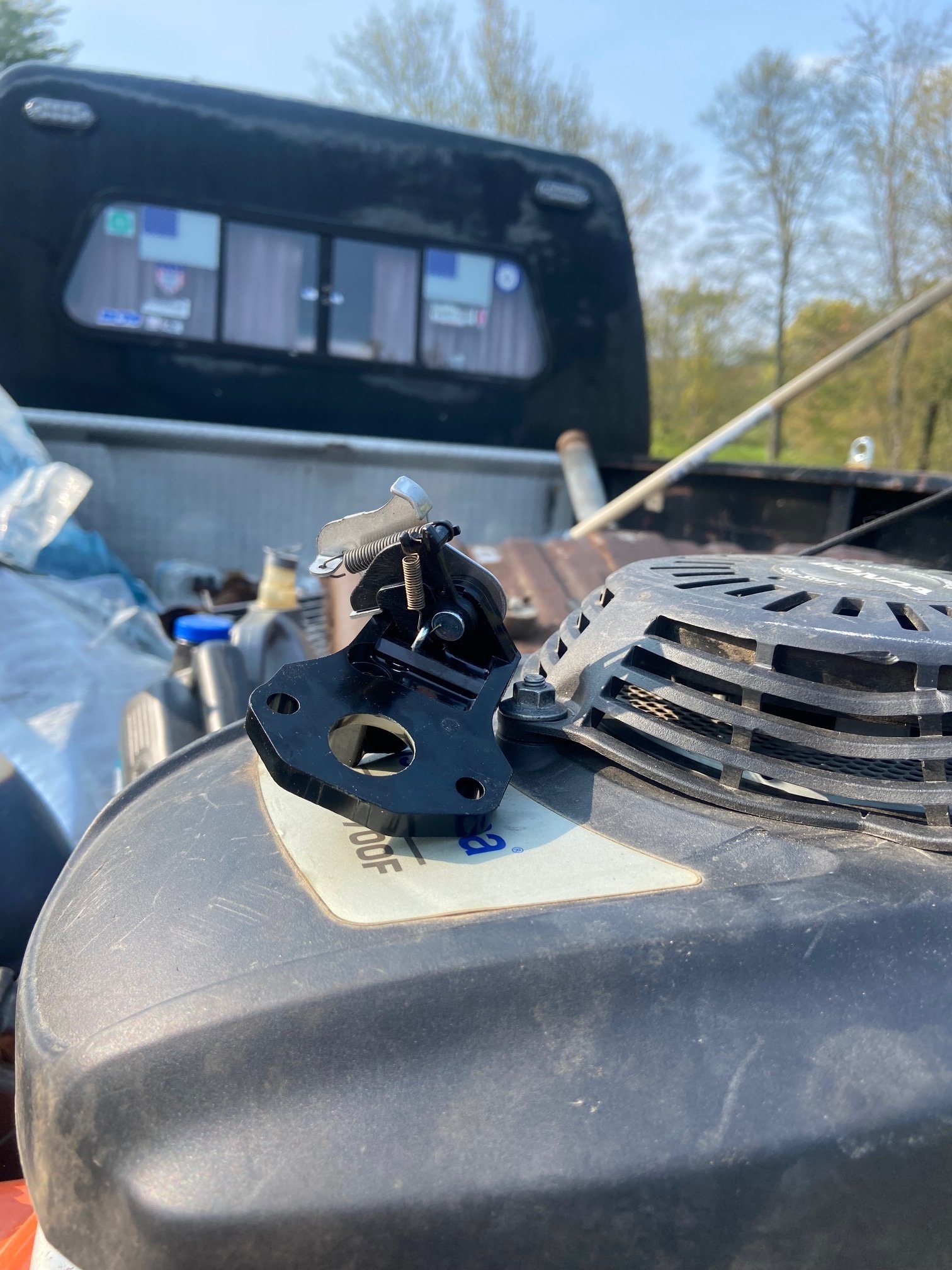

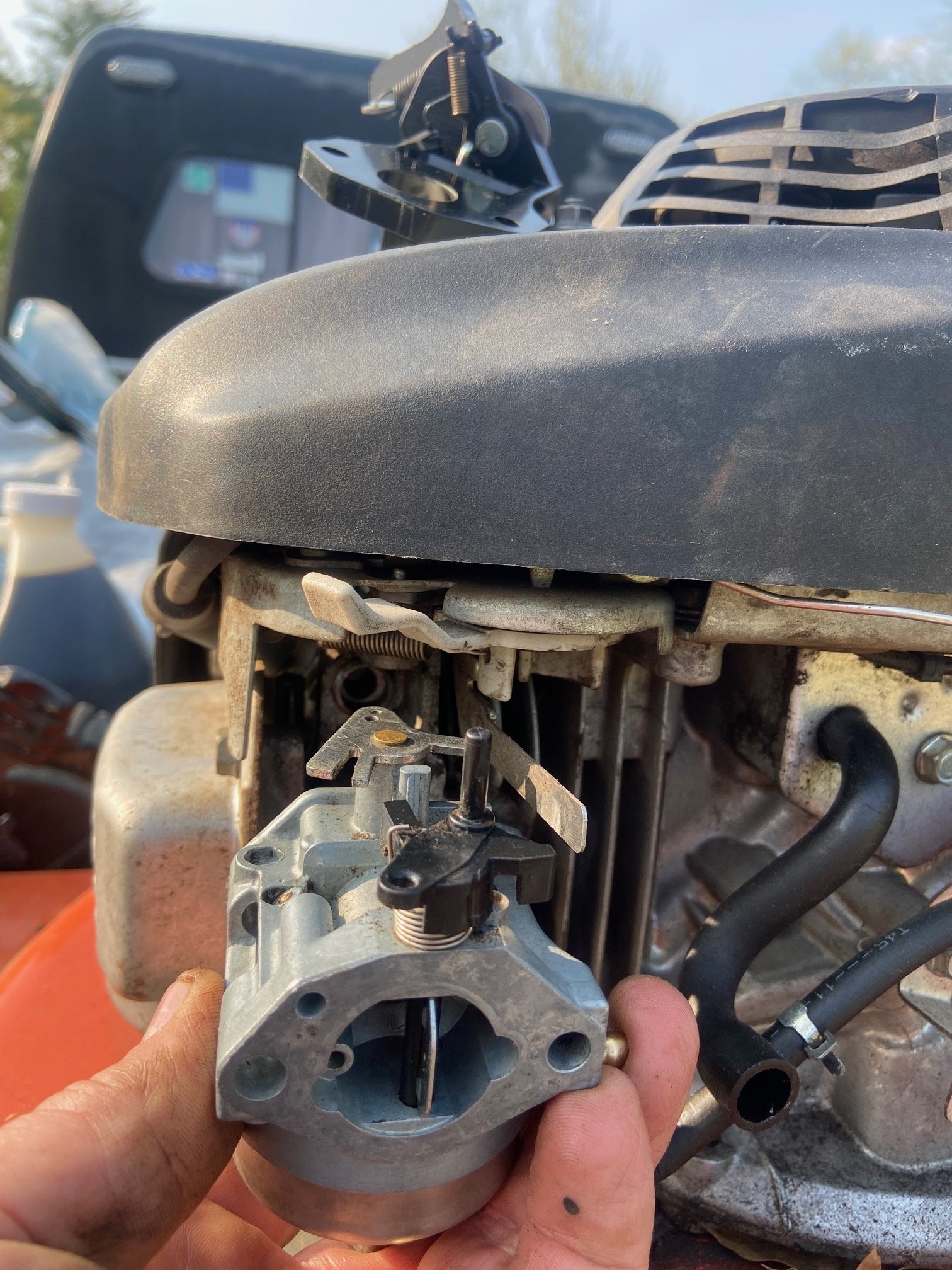

I pulled one of these home from the dump - had never seen a Honda engine on a Husqy. The choke setup isn’t setup correctly and I’m hoping someone can share a picture of how the choke connects to the carb. I can’t find a diagram that shows it - and it is a rather unique setup.
Thank you.
Jay
   / Husqvarna HU 700F carb/choke #2
Can you share a photo of what you have and explain what the problem is ?
Sorry for the delay. Here's a few pics and a video (
) that hopefully show what I"m talking about. Again, just needing to know how the carb connects to the choke assembly...

The lever that activates the choke is that arm just under the blower housing , kind of front left on the engine. Just put the carb on so the piece of spring steel pushes the choke closed when the choke lever is pulled back. The black plastic control doesn't belong on this.
Hey Tom. I went out to bolt the carb/air filter etc. back up and am finding that the bolts that were on there originally are too long "as is" with just the carb and the air filter housing. Ironically, they seem to be too long by the thickness of that black plastic control.... Wondering if I might need part # 32 in the attached??
FYI. There were no gaskets on the carb when I got it so I found some like #26 and #12 and put them on there, but still have the 1/4" gap I'm noting.... :cool:
