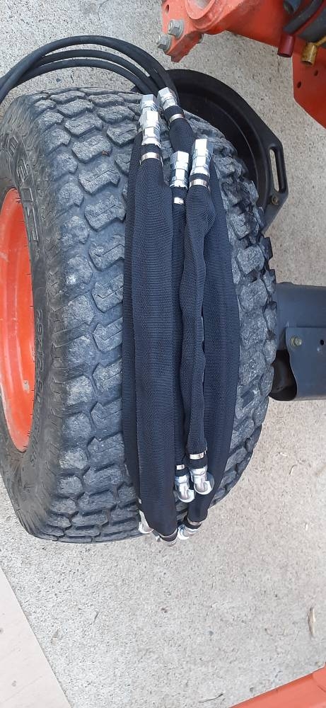

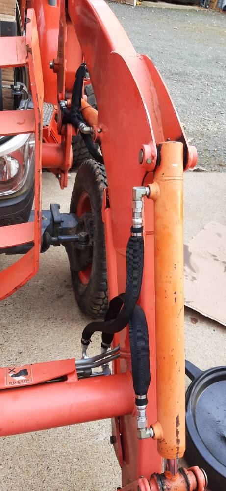

This is what I used on all of my hoses, and the 1.25" size for a couple of larger hoses. Worked great.
Pics as I installed them on the FEL and backhoe. As previously mentioned, they protect the hoses from UV and chafing.

I started covering all the hoses I replace with a nylon sleeve, mostly for UV protection, but also for abrasion.

Nice job. What are you using on the sleeve ends to fasten them?
I used these
