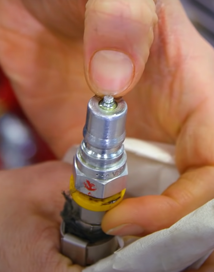

Does anyone know what hydraulic quick couplers that Ventrac uses?
This is all that the parts manual suggests:
   / Hyd. Fittings - Ventrac #2
Look at the chart.
If you print it, it's to scale just match it up.
They all look similar, but there are slight differences and they won't interchange.
Once you figure out the ISO designation....it becomes easy.
I rarely see 7241 series a. But series B are pretty common, as are the iso 5675 which are referred to as "ag" couplers
Thanks for the help - it looks to be ISO 7241 Series B
   / Hyd. Fittings - Ventrac #4
Looks to have some writing stamped on it. What's it say?
I cannot confirm or deny what it is based on a pic.
Look at a side profile and match it up to the chart
For others, couplers are ISO 7241-1 Series B, 1/4" body
