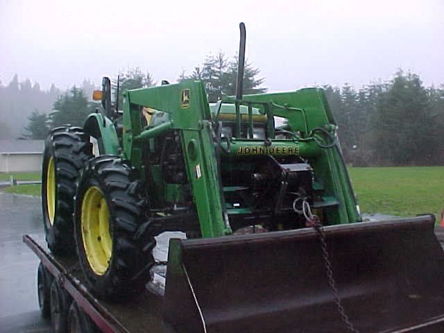

I mounted an 8000lb unit in my loader and am using the extra remote ports on my 5300 jd. no problems. Its's been on there for 5 yrs. Here's a pic.

   / Hyd. quick connect problems? #5
Hi Diggerjam;
My hyd system put out 16-18 gal a min.
The quick disconnects, I don't think hold the oil back much at all. They are the same ones that jd engineered for anything that you would hook to them. My loader hooks into the stock ports on the back and the remote I use for the winch is the same. If you were restricting much you should hear the relief howling. With mine putting 18 gpm, anything less would be not be a problem.
I haven't checked the line speed on it, but it is in tune with the tractor when I'm in 3 in creep gear. That is if I'm stuck and am pulling with the winch and helping with the tires, there is no noticable slippage from the tires.
The winch is a 36-1 ratio. I used 90 w that it came with but there was always seepage. I filled it with some good grease and I mean filled full. It just about doubled the pulling power, I couldn't believe the difference. It will pull the tractor on dry pavement in four wheel drive with the brakes locked up.
What you can't see, is a sturdy eye that I can attach a small pulley to on the backside of the bucket. I use that at times if I need a sideways pull, keeps the line going in the winch properly.
I have some rear winch pics from pto units that I built. The winch is the same, just a hyd unit instead. I need to get them scanned though.
have fun with it, Randall
