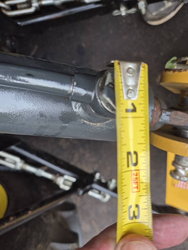

I have a John Deere 3038e, 2018 490hrs and just washed (garden hose, not pressure wash) foam cannon & rinse. Putting it away on dash warning said "PTO coil fault". Never happened before & just a 10 minute wash. After idling warning went off & PTO works fine.
I'm trying to figure out what would be that water sensitive?

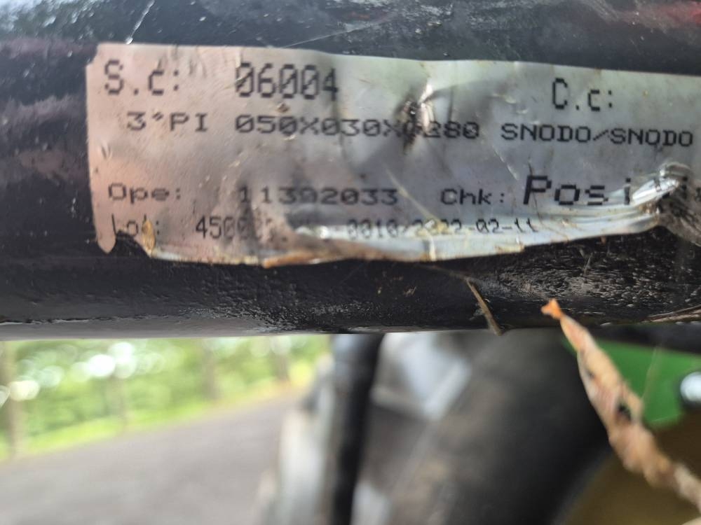

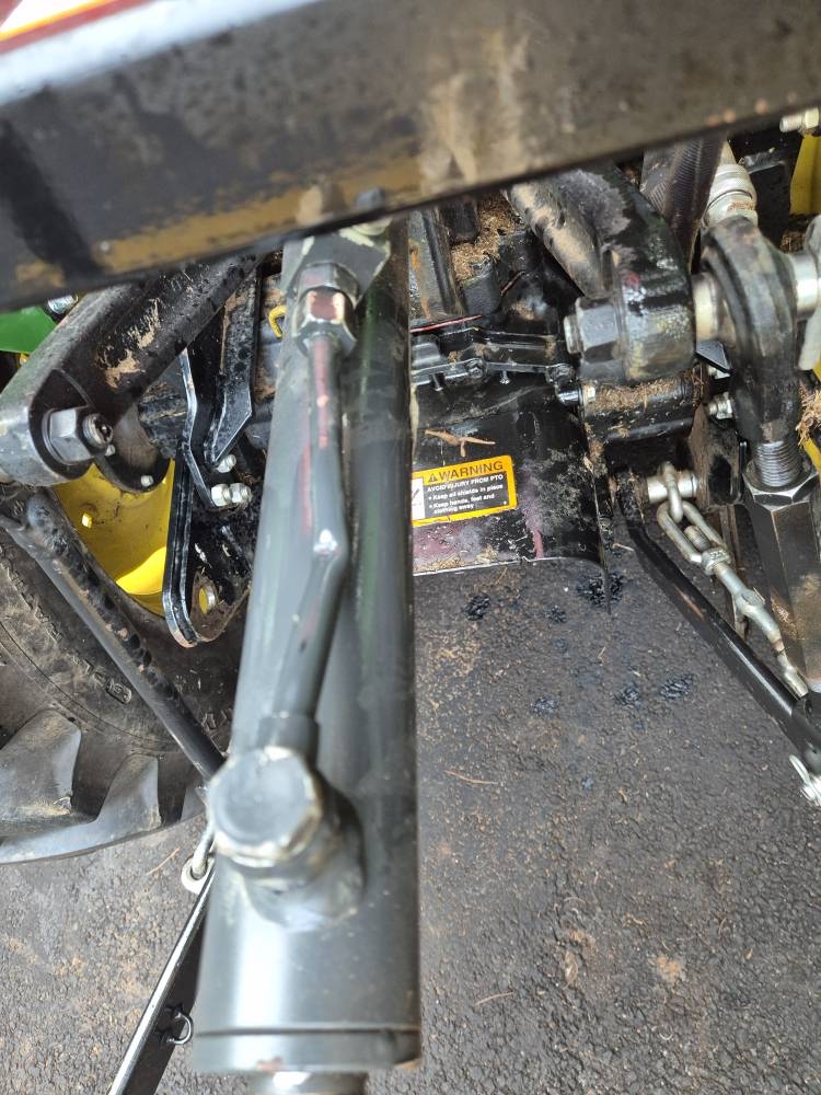

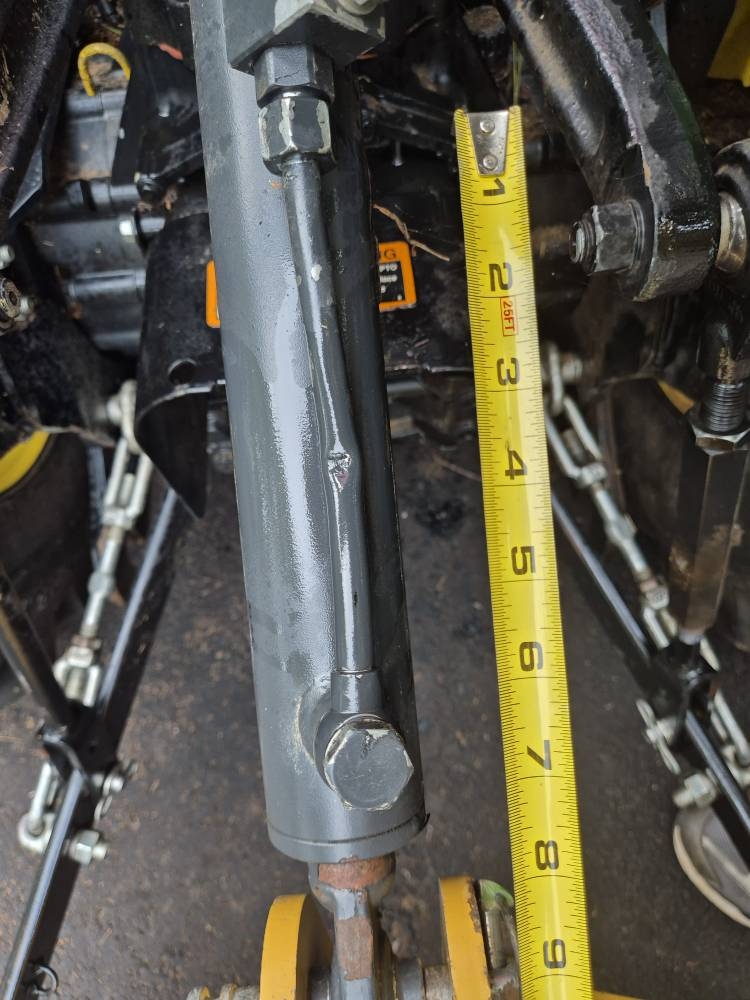

The main problem is I had ROPs down and lifting back blade bent the top link 1/2" O.D. pipe on it (third time I've done that!). Will this Surplus Center kit work?
If I mount link upside down hoses won't reach. Any ideas how to protect/prevent it from happening?

Could you get that piece made as a hose?

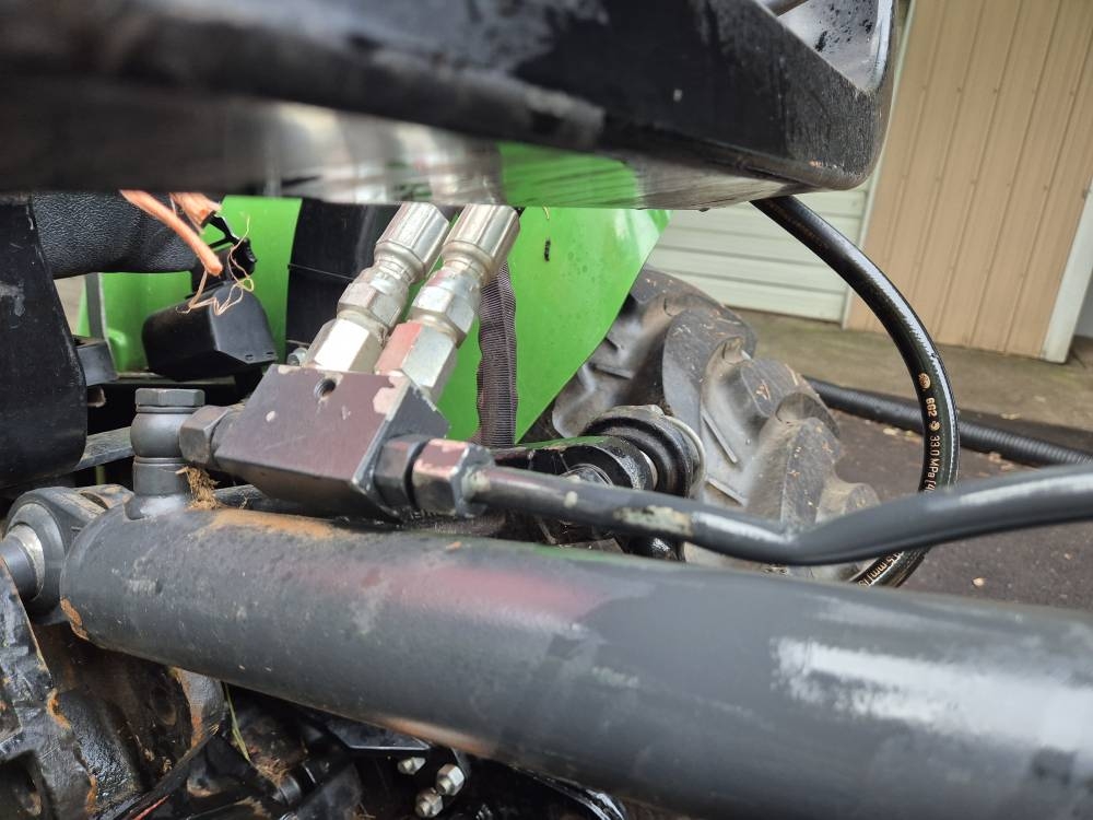

Why can't a banjo fitting be crimped onto a hose?
I'm fairly sure that one of my BH hoses has a banjo fitting on the end of it ...
Or maybe build a shield over the "crush zone" to protect that area from future catastrophe's?
