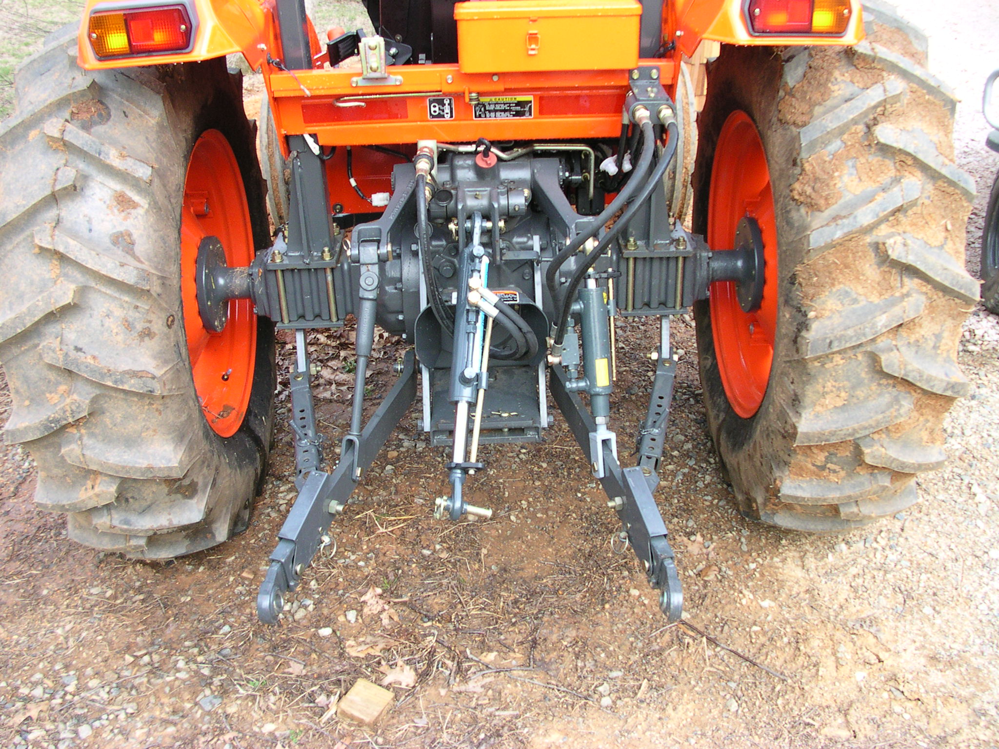

If it helps any, here is a picture of my M4900 with the CCM Top & Tilt system. The Top cylinder is a Cat 1 size. The extension length is great but sometimes I wish it would retract a tad more. I moved the attachment point lower to compensate and that worked fine.
   / Hyd. Top Link
FarmGeek, what is the length of the cylinder when closed? And what's the stroke on the cylinder. I'm wanting to be sure to have enough retractable length also. Thanks for pics too. Did you get this from CCM?
Wayne
Wayne
Hi mr.wayne,
I will happily measure the top link once I get back to the farm but that won't be until next weekend. Work, or that place that enables my tractor addiction, is keeping me away this week.
It is a CCM system. They even made the hoses for me.
