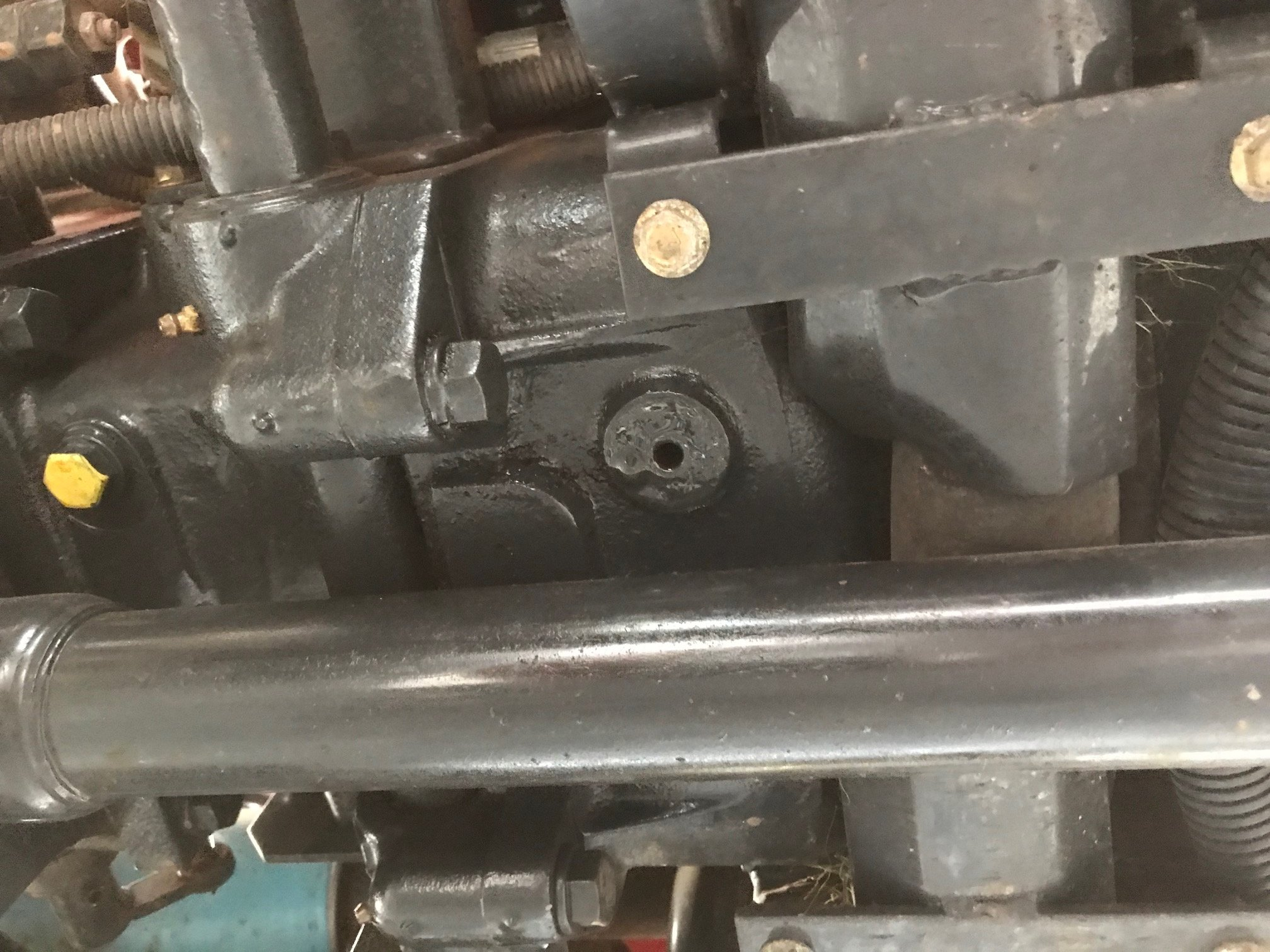

hello
branson 3510 H leaking from bottom of what I believe is called the range shift drive shaft case ,{ its the small mid case}.
there is a factory formed hole fluid leaks from.
My question is should there be a plug or bolt in it , has mine come out?

View attachment 797908My question is should there be a plug or bolt in it , has mine come out?
To be honest I don’t know, but on some a small hole is left open so oil can get out and not build up if something goes wrong. Hopefully someone with more knowledge will chime in

My New Holland TC30 leaks out of an identical hole. I'm pretty sure the hole is supposed to be open.
