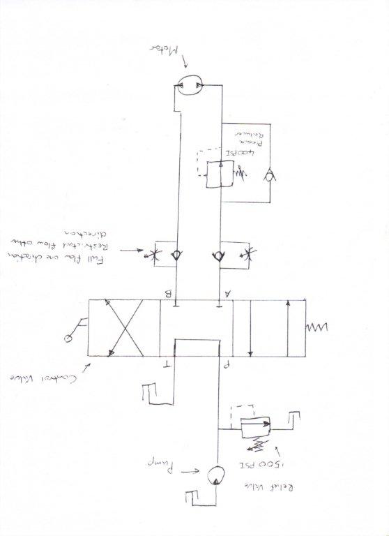

Can you show some rough drawings and some pictures of the drilling rig.

Ok Bob
You can put a a Pressure Reducer ( with a check valve ) on one side of the motor circuit. This will allow your pressure to be reduced to 400 PSI when drilling, but allow you full pressure to bring the drill string back out of the hole.
I have done a rough hydraulic schematic, which looks like it should do the job.
I will add some flow restrictors as optional extras, so you can adjust the speed of which you want to the hydraulic motor to turn when going up or going down with your top drive.
I just need to clean up my mistakes, scan it, do a few jobs around the house and I will send.

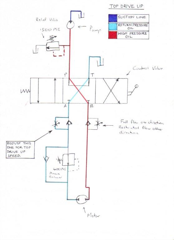

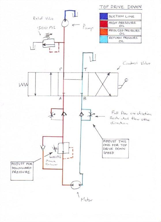

Hi Bob
I have done the one schematic in the nuteral, down and up position.
I have tried to colour in the different pressure oil to help you get a understandng of it.
In the schematic, Im assuming;
1/ you have fixed displacement gear pump
2/ you have a fixed displacement gear motor
3/ Your relief valve is set at 1500 PSI ( as you have mentioned )
I have added flow restrictors, so that you can adjust your speed for up and down.
I have not added return filters on the schematic, but Im sure there on your system.
OK, Im sure there will be critisim or quirey's, will do my best to answer all, time permitting.
Duff

Hi Bill
If its a piston motor, then it will have to have a case drain ( and it should not be blocked, or it will blow a seal ! ) But you can put flow restrictors on the return side, as the shaft seal does not see full pressure ( Unless your pressure plate in the motor has had it !! ).
If it is a gear motor, it should not matter too, because if the motor is stalled out anyway, it must be capable of taking full pressure ( 2500 PSI ).
You had me thinking on the reason why manufactuers always put there flow restrictors on the return side. As having a flow restrictor on the pressure side would work too.
But I think it comes down to effeciency. The pump/ engine ( more fuel ) would have to work harder to do the same job, because the oil would have to get through a restriction 1st before it had to do its job, at the actuator.
With the flow restrictor on the return side, the oil would do the work at the actuator 1st ( with out any restriction ) before its restricted on the way back to tank.
However your right, when your using flow restrictors, you must be careful how much you restrict the oil, as in cylinder circuit, you can get "pressure intensification" and blow hoses etc.
Cheers
Duff
If inertia and/or gravity can make the motor move/drift, meter out restriction (return side), will cure that problem
If motor is designed for bi-directional use, a meter out restriction should be ok.....
(reservation for meter out restriction on extending a double action cylinder, calculate the back pressure before final design)
Btw....You did some great drawings and it all looks good to me....:thumbsup:
